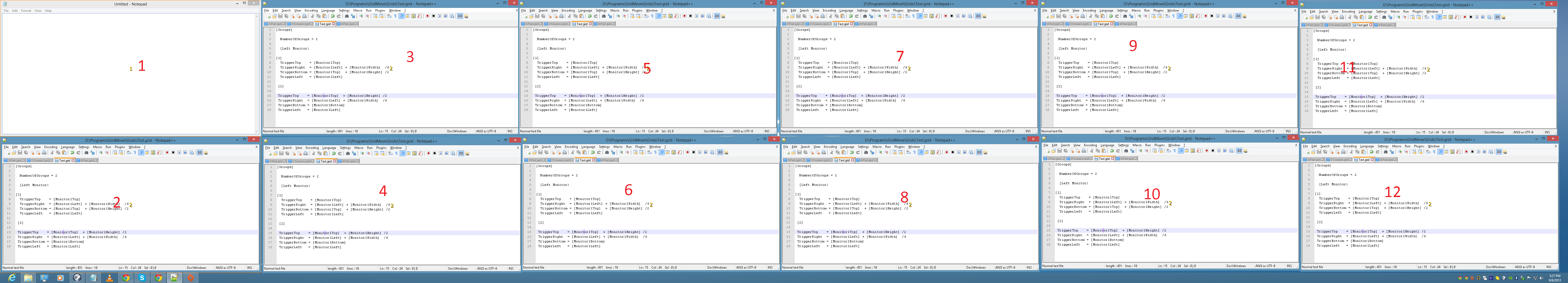

the grid works but I have 1 small issue I am unsure if it is even fixable.
so here is the issue, I use NVidia surround and as I mentioned this takes 3 screens as 1 huge screen, well there is a thing called "bezel correction" what happens is it will remove "x" amount of pixels on the screens so that they all line up as a consistent image, well for me it is set to 110 pixels removes, I cant see the edges of windows (example: exit button on windows etc), which is actually very needed, and I am unsure if you have a way to fix this?

you just need to move everything by the requisite amount, eg for panel [1]
  TriggerTop      = [Monitor1Top]+110 ;this moves the top bound down 110 pixels
  TriggerBottom  = [Monitor1Top]+[Monitor1Height]-220/2 ;this takes 110 pixels off the top AND the bottom to allow for the reduced screen height
you can do the same for the left and right bounds

AWSOME! that worked, it took me a few trys but hey it worked! thanks!
i have a small question if i would like to make 3 separate 1920x1080 windows (since its 3 monitors as 1 = 5980x1080) would i divide this in 1/3? to be able to place the windows in such a way?

the problem with specifying more than 1 monitor is that it wont work because it is listed as one. here is a picture
here is a picture of the actual grid, if you look close you will see where the monitors break off as separate ones where i had to add that "110 pixels"
so essentially where you see the block of 4 squares i would like to add one more grid that allows full screen the windows to that specific screen/monitor/space which is 1920x1080

  • Posts: 11
Re: need help setting up grid with a large display
« Reply #21 on: September 13, 2013, 04:47 PM »
ill give that a try, but here is also an interesting issue i have yet to figure out why #32 wouldnt work, all the others work fine
See image
http://i.imgur.com/Ffd5gjC.jpg
« Reply #22 on: September 13, 2013, 05:56 PM »
Ah, I see your problem. Adding to an existing grid won't work, because the elements overlap completely and the elements with smaller indexes will always have priority.
You need to use triggers for your grids. When you omit the "Grid" part of the configuration, it creates a grid and a trigger which are exactly the same. However, it doesn't need to be like this. Here's a simple example:
Code
[Groups]
  NumberOfGroups = 2
[1]
  TriggerRight  = [Monitor1Left] + [Monitor1Width]  /2
  TriggerBottom = [Monitor1Top]  + [Monitor1Height] /4
  TriggerLeft   = [Monitor1Left]
  GridTop    = [Monitor1Top]
  GridRight  = [Monitor1Left] + [Monitor1Width]  /2
  GridBottom = [Monitor1Top]  + [Monitor1Height] /2
  GridLeft   = [Monitor1Left]
[2]
  TriggerTop    = [Monitor1Top] + [Monitor1Height] /4
  TriggerBottom = [Monitor1Top]  + [Monitor1Height] /2
