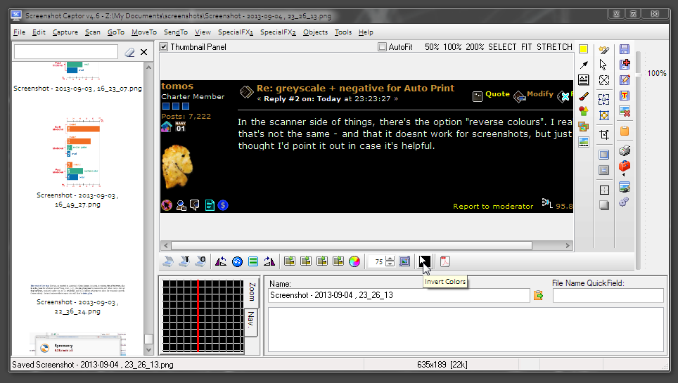

« Reply #4 on: September 04, 2013, 09:41 PM »
I wasn't sure if the greyscale needed to happen before the invert colors thing.  I didn't know if a color image inverted very well.  I think the author of the abandoned PrintScreen32 software had the invert as a sub-option of the greyscale option because it might be strange if someone inverted an actual color image ...
yes, it is :)
But I just noticed, you can also use this option for inverting colours of screenshots (see mouse pointer in screenshot below).
(I say this also for mouser's benefit - he's been known to forget what his programmes are capable of :D)

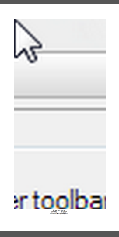

For auto-print do you use the post-capture dialogue?
Is there any way to print an image @ 100% - I have to ask myself what is 100% when converted to a page, and I'm not sure.
But this is what I get when I use the post-capture dialogue and choose "Normal" (*not* 'Fit to page' or 'Stretch to page'):
NB: the height of the white area there is A4 width (210mm - I got it very roughly that size on screen here) - (the page is landscape format)
The original image is this size:
But the main point is that it's definitely been enlarged a lot - enlarged to page size.
I believe this is related to the behaviour when creating PDF's using a scanner - images are also enlarged to page size as oppoised to keeping actual measurement. See here for more details.
With the screenshot, as said, I'm not sure what 'actual' measurement is when printed ...
