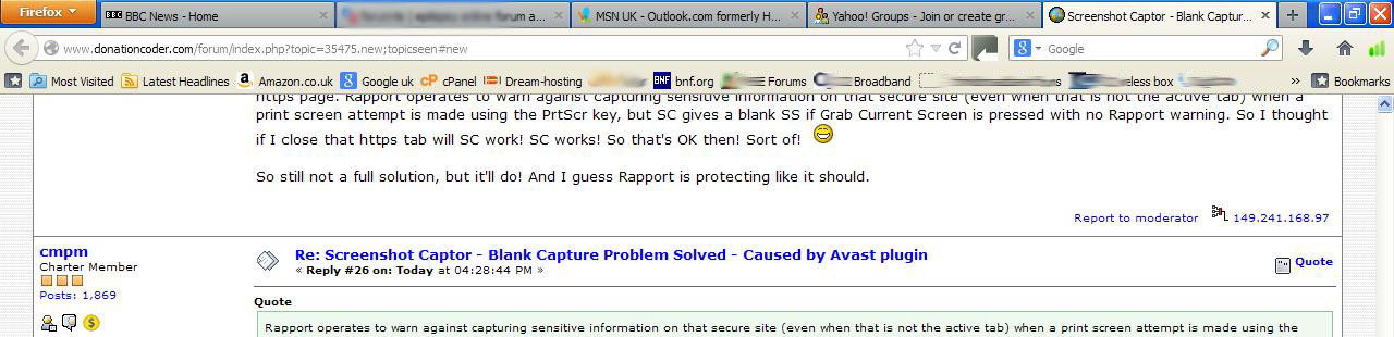

The second tab from left is the secure one, but if I try to us PrtScn to capture the content of this forum in the active tab, I get a Rapport warning when I try to capture what I did below, (or a blank with SC).
