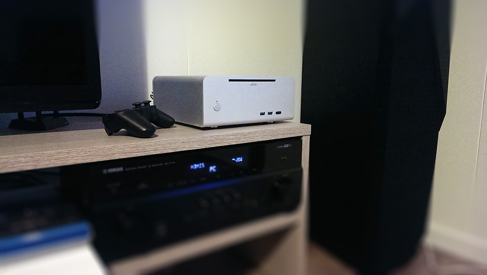

About 6 months back, I set up a HTPC for myself with a Streacom FC8 Evo Fanless Chassis, a MSI Z77IA-E53 mini-ITX motherboard combined with a Intel Core i3-3225 and a Samsung 840 Pro SSD 128GB. As for the PSU, I used an external one also from Streacom. I recently also installed a ASUS PCE-AC66 wifi card to go with my 802.11ac network. This setup is more than powerful enough to run any video I throw at it (including bluray, using this drive combined with SlySoft's AnyDVD HD), boots within in a handful of seconds (running Windows 8​) and is 100% silent (well, except while using the optical drive of course).
As for software, I primarily use XBMC but if you're mainly into music you should probably take a look at Jriver Media Center 18, which I use on pretty much every other computer I own. If you got an iPad it makes for the perfect controller for both software solutions. For XBMC, I use XBMC Commander and for JRMC I use and absolutely love JRemote. Whenever I have to use a mouse+keyboard, I'm using Logitech's lovely K810 bluetooth keyboard (back-lit, rechargeable) and Apple's Magic Trackpad.
The only drawback to this setup is that it'll probably cost you a bit more than you had in mind, depending on what hardware you got laying around. It was also not exactly the easiest chassis to build (you'll need *plently* of thermal paste, and assemble things in the "right" order), but in the end it was well worth it.
EDIT: Here's a picture of the htpc, with a PS3 controller placed besides it for size comparison.
[attachtimg=1]
« Last Edit: July 10, 2013, 12:06 AM by Dirhael »

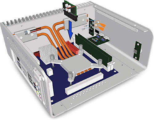

what kind of cpu fan are you running on your i3?  Even the lowest profile ones I've seen for LGA 1156 sockets are pretty space hungry, so I was wondering.
Dirhael
  • Posts: 387
I'm not running any kind of fan on the CPU at all, it's all passively cooled. The heat-pipe design should be able to handle any CPU up to 95W, and the i3-3225 is only 55W :) The entire chassis is made of more or less a single block of aluminum, so the entire thing is essentially a massive heat sink.
« Last Edit: July 10, 2013, 01:45 AM by Dirhael »

Even under load the heat doesn't spike?
Well, it's not at any time what you would call cold, but even under load it runs within what's safe. I probably wouldn't compile software 24/7 on it, but even under load I've yet to have it throttle due to high temps.

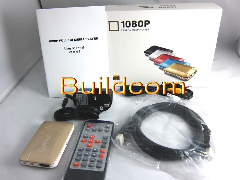

I will give a huge  :up: :Thmbsup: to this little chinese device that seems to have no problem playing back 1080p.  All you need is to attach a usb drive to it and it will do the rest.  It's only $60 and I take it with me everywhere.  It's from a company called Diyomate.
Now, your tv probably has multiple inputs.  Put the diyomate on one input, this will be where you watch all your movies.  For your internet requirement, get the android stick i was talking about, called the mk808b:
Now, to control the internet from that android interface, you need some kind of airmouse.  I've heard the gyration and mx air will work with it, but I haven't confirmed it.  But sticking to this chinese theme, you can buy a cheap airmouse that does work well, called the rc11:
The remote has a keyboard on it to boot.  The more expensive and better quality option is the gyration mouse/keyboard combo.
But using this route, you get everything you want, and it costs total under $200.
