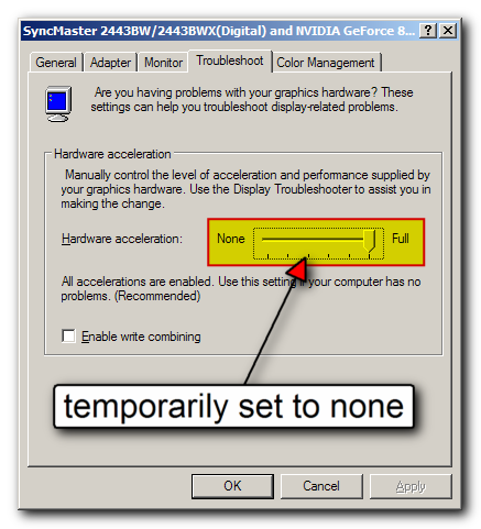

1. Windows Widgets won't capture?
I suspect this means they are using some accelerated graphics rendering to display, much in the same way that video playback can, causing screen captures to be blank.
When you can do is temporarily *disable* HARDWARE ACCELERATION for your graphics card (found on Troubleshooting tab of video card properties dialog) during capture, and then re-enable it.

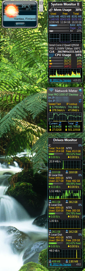

Well... the screencapture isn't blank. My desktops background is visible on that screencapture but widgets on top of that, aren't.
On this screenshot, you'll see my desktops area where my widgets are (my ip-information blurred to protect innocent...)
And this screencast from very same is done with Easy Screencast Recorder shows no widgets.
