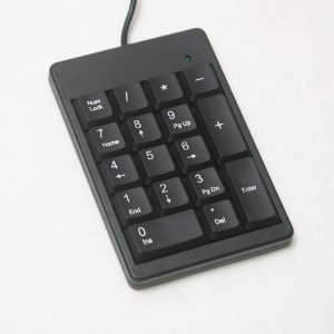

The best solution I have personally come up with is to get a USB keypad, like so:
Personally, I've considered getting one and scraping off the characters so I can re-map all the keys to make a poor man's MIDI controller.   8)
Or, you can use something like StrokesPlus or Just Gestures to make mouse movements into shortcuts for 'Home' and 'End', or find some keys you don't use and re-map them with AutoHotkey.

Keypads with Notebooks, for numbers? Might be possible in some cases. In most cases, and with most notebooks, this is not possible, though, since the numkey setting necessary for the keypad also switches the numkeysetting of the notebook keyboard, and only some keypads promise to do this properly, meaning differently for the keypad and not affecting the notebook, and even with some of these (Hama, with special advertising on this matter), I had extreme problems, a minute it worked properly, the next it switched those keyboard keys to numbers, after some typing on the keypad - it was a nightmare - so I discarded keypads for notebooks a long time ago. (There is always the venerable Cherry 4700, but that costs four times the price and runs with special software, but then is excellent and doesn't cause any problems, except by its size.)
But here the task is the other way round: The keypad would not be switched to numlock, but have all these navigational keys handy that on the notebook are too tiny, and just replicating them. And this means Edvard's advice is brilliant, as long as you don't try to enter numbers with that keypad: Spend 8 or 10 bucks, and have all these navigation keys in due size and in proper arrangement! (But bear in mind no macro program will be able to distinguish between them and those on the keyboard, meaning you will just "lose" the latter, not have them available for other commands - in case you think of combining these solutions.)

Edvard,
I had never seen one of those before, I looked them up and found a selection on Amazon, all reasonably priced, I would prefer not to add any hardware but it is worth keeping in mind.
Mouse movements are not really an option as switching between keyboard and mouse is something I try to avoid doing more than necessary.
