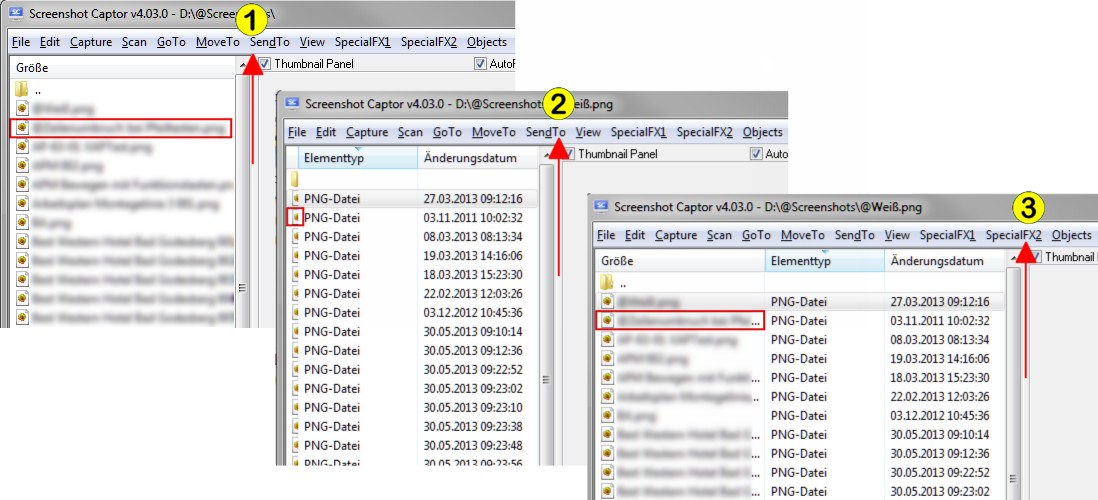

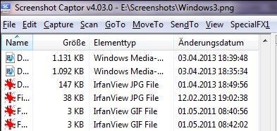

I have a problem with my preferred view "Screenshot panel: List on Left", This view is broken or I don't understand a new feature.
If I chose "Screenshot panel: List on Left", the details view is shown on the left with a name column of 1 cm wide. Size, date and type are shown much wider.
So the name can't be read.
I tried with a new INI but the result was the same.
I tried to switch off the size, date and type columns and resize the name column, but SCC doens't remember this view.
Is it a bug or a feature?
Ralf

Yes, its version 4.03.0.
Additionally I found that the name colum only is made smaller if SCC main window is left in full view.
If SCC is closed in reduced view and started again, the name column shows full name.
On switching to full view name column ist made smaller again and stays small even if I switch back to reduced view.

I've found a new fact for this problem:
If Screenshot panel on the left is small (e.g separator is between "MoveTo" and "SendTo" in menu) the list view is OK with wide name column.
If Screenshot panel on the left is a little bit wider (e.g separator in the middle under "SendTo" in menu) the name Column is only 3 mm wide.
In this state a further increase of the width of the Screenshot panel only changes the width of the name column.
Ralf
