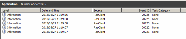

In Computer Management->Event Viewer->Windows Logs->Applications there'll be the results of rasdial commands, a successful connection looks like:
What do you get if it's not the same, (and the actual event data not a picture, thanks) ?

« Reply #6 on: May 27, 2013, 12:43 PM »
OK, a partial report:
I tried enabling the R&RA service nothing changed.
Tried tracert (7):
1 General Failure.
Checked Event Viewer and it showed the following for one failed connection:
CoId={AE3F56B9-E6A4-4FCF-BB7B-1DBE6D654A5E}: The user PILGRIMS-PC\Pilgrim is trying to establish a link to the Remote Access Server for the connection named VPN - NL using the following device:
Server address/Phone Number = 'IP Adress'
Device = WAN Miniport (PPTP)
Port = VPN3-1
MediaType = VPN.
For another failed connection it showed:
CoId={63B5372A-8D8F-4644-925E-8E40E890A72B}: The user PILGRIMS-PC\Pilgrim has started dialing a VPN connection using a all-user connection profile named VPN - NL. The connection settings are:
Dial-in User = 'username'
VpnStrategy = PPTP
DataEncryption = Require
PrerequisiteEntry =
AutoLogon = No
UseRasCredentials = Yes
Authentication Type = CHAP/MS-CHAPv2
Ipv4DefaultGateway = Yes
Ipv4AddressAssignment = By Server
Ipv4DNSServerAssignment = By Server
Ipv6DefaultGateway = Yes
Ipv6AddressAssignment = By Server
Ipv6DNSServerAssignment = By Server
IpDnsFlags =
IpNBTEnabled = Yes
UseFlags = Private Connection
ConnectOnWinlogon = No.
Both of the above showed error type = Information.
When it showed an Error it was:
CoId={8E0F690F-7BF5-4925-99D4-05E12EC4C3B5}: The user PILGRIMS-PC\Pilgrim dialed a connection named VPN - NL which has failed. The error code returned on failure is 807.
