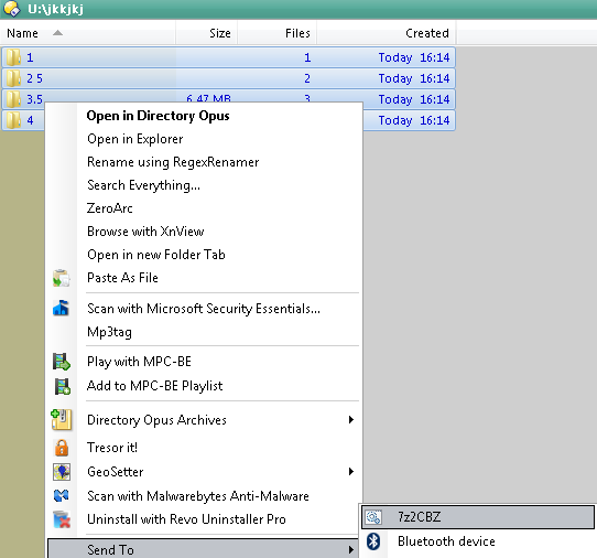

Put the batch file somewhere, edit it so that it's pointing to 7z.exe, then create a shortcut to it in %USERPROFILE%\SendTo, eg.
2013-05-08 16_42_53-C__Users_4wd_AppData_Roaming_Microsoft_Windows_SendTo.png
To use: select your folders in Explorer, DOpus, etc, right-click and select Send To -> 7z2CBZ

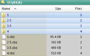

eg. From this:
You should end up with something like this:
Obligatory warning: There's no checking for any kind of error, eg. if you selected files instead directories.  That said, it works for me :)
