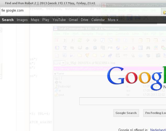

you could try this fsubscript plugin fie
usage
   fie www.yahoo.com[space]
installation
first install farr fsubscript (see elsewhere in this forum)
create folder fie under plugins e.g.
c:\program files\farr\plugins\fie
in fie v2.zip you'll find fsubscript.js and fie.ico, save these in the new folder
after unzipping and copying the files
restart farr plugins:
goreload
click on OK button
example:
fie www.google.com[space]
or
fie google.com[space]
[attachurl=#]
fie = farr internet explorer
