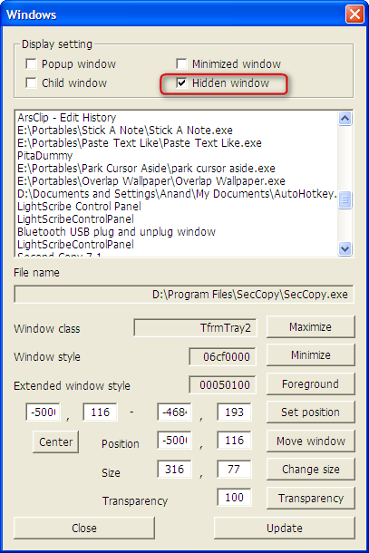

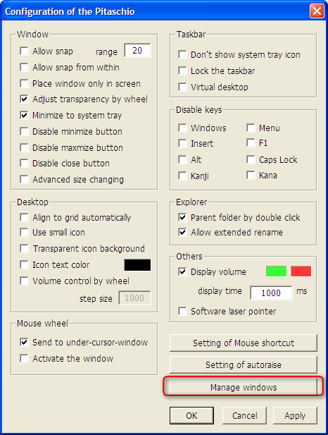

« Reply #6 on: March 18, 2013, 08:23 AM »
Hi rjbull,
In case you have problem in finding the required feature, I am giving below the screen shots from my machine.
The below window comes after you right click on the tray icon and select 'Settings'.
Hope it helps you.
Regards,
Anand
Many thanks!  :)  I wouldn't have found that, even though I know perfectly well that my sticky notes program makes all its notes hidden windows.  Pistachio is an interesting utility; pity it doesn't show icons as well in that list.
