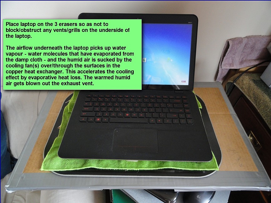

However, if the service is overdue, or if the PC has got some seriously heavy CPU load on and it's a hot day, then I set up a Hi-Tech laptop cooling modification that I invented years ago. The other day it was a case of "some seriously heavy CPU load on and it's a hot day", and I was in a non-airconditioned area.
It's moving towards midsummer where I am in NZ and after a bit of a cold start it's getting hotter, grassy areas are turning brown, and the fire danger warning signs along major roads through country areas are up to "High" (which is typical for this time of year). My laptop's Intel i7 was running a couple of CPU-intensive processes at about 13 percent each and the cooling fan was working at high speed but holding the temperatures stable. I could see the hot spots by looking at the Speedfan monitor display.

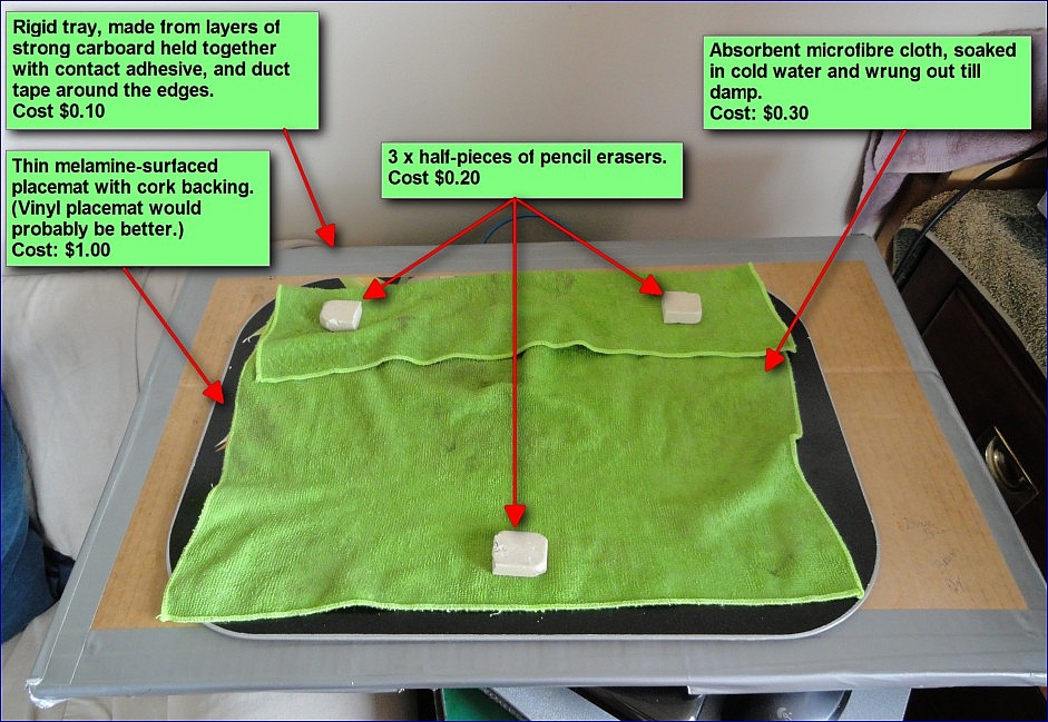

So I enabled the Hi-Tech laptop cooling modification:

My answer to the first question would have to be "No". The empiric approach described actually works, and so far unfailingly, over the several years that I have used it.
Normally humid air is going to be sucked into the laptop anyway. The HTLCM (Hi-Tech laptop cooling modification) just makes it more humid, that's all.
If you are worried about condensation, don't be. You would be unlikely to get condensation forming inside a warm laptop, but I suspect that dropping it into a freezer could cause condensation to form somewhere - probably on the copper heatsinks especially - until it has all warmed up. Being a bit paranoid, I wouldn't advocate the freezer approach for that reason, though I could be wrong, of course.
I think @Renegade's idea of putting ice as the filling in a sandwich of cloth is worth exploring for laptops that seem to run critically hot, though in my experience, laptops that might run that hot may often be overdue for an inside clean, as described.
If your cooling air pathways are clear, then using the HTLCM could significantly drop the CPU (and maybe also disk) temperatures in a short space of time.
