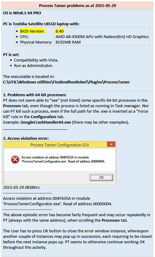

Just for the record, I'm using PT in Win8.1 PRO-64, and it seems to work OK.
Since making the above comment/post I have reason to suggest that it looks as though PT does have problems with at least some 64-bit processes in Win8.1-64 PRO. Not sure if the two problems below are connected:
Thanks for the report, Iain.
I will fix.
