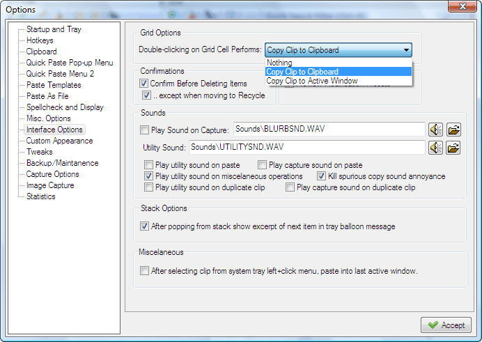

Have you checked these Options?  I wondered if you had Double-clicking on Grid Cell Performs: set to Nothing.  Also, this is the Options screen where you turn sounds on and off, which is most likely where you need to go to turn the funny sound off.
