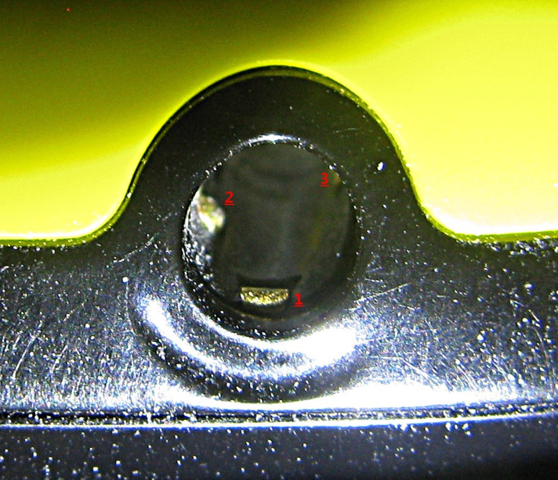

It's listed as an accessory for the Samsung Series 9 13" notebook, (which are fairly recent models, IIRC) - these notebooks have a combination headphone/microphone jack.
Any chance of a good photo of the AUX jack, (hopefully to be able to see how many contacts are in it) ?
If it's more than two, then I'd say that it accepts input from the combination jack on the notebook - in which case you possibly need a 4 wire 3.5mm patch cord, (3 + ground/shield).

@4wd:I cannot get at the AUX to see what it is. Would seem to require breaking the casing to get at the innards, and I am unwilling to do that just yet.
I meant a photo into the AUX jack from the outside - you should be able to see into it and see how many contacts it has.  You might not be able to take a photo but you should still be able to count the contacts made when you insert a plug.
You may even be able to feel how many contacts there are by inserting a plug, you'll get a distinct "click" as the notch at the tip moves past each contact.
eg. Here's the jack on my mobile, (not the best photo due to angle - there's one more contact right at the bottom):
