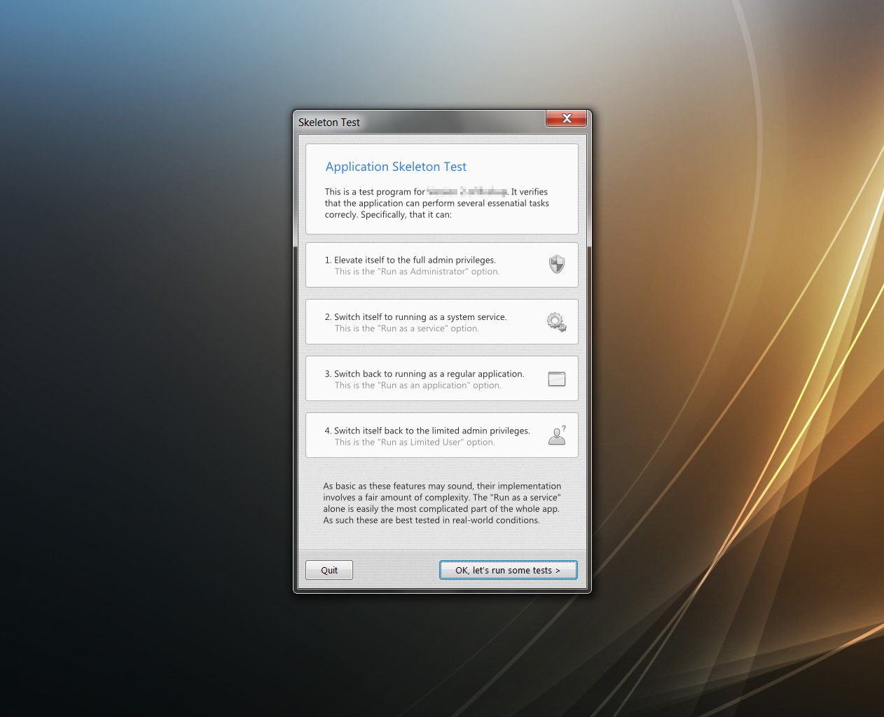

« on: November 19, 2012, 08:21 AM »
Hi guys,
I am in the process of designing a UI for a Windows app, and the stylistic/visual side of it is proving to be quite a task. Unlike 5-10 years ago, the spectrum of employed design choices is now pretty wide. Native UIs are still here, but they are being supplemented by better looking UIs like those of Chrome, Firefox, Evernote, Acronis and others. There are also UIs that go for full customization and resemble more a web app than a Windows program, e.g. Kaspersky and iTunes.
What I'm trying to do is to find the balance between sprucing app the UI and still retaining the native look and feel. I have sketched out few options, and I'd like to get an opinion on one of them.
Does these customizations come across (even in a slightest way) as annoying or inappropriate? I'll take all opinions... i.e. not just from the UI purists :)
Thanks
Alex

« Reply #1 on: November 19, 2012, 11:38 AM »
I am pretty far from being an UI specialist, but I am always happy to offer my oppinion :-[.
I think it has a slight bit of the "mac" feel to it, but you have added just enough black to the icons to not make it too bland. I still wonder if perhaps a touch of pale coloring on the icons might work, just like the blue in the heading works?
I assume you did not make the texture on the border of the window, but for this particular one, I find the edge where the glassy shadow on the border starts (slightly below the edge of the second box of text) to be rather distracting. When I first opened the post and glanced at the screenshot, I thought it was one window at the top that cut of the top bit of another window below it.
And, nitpicking, I feel there is perhaps slightly too much space above and below the final paragraph of text at the bottom.
Re: Thoughts on this sort of UI styling?
« Reply #2 on: November 19, 2012, 12:37 PM »
I won't comment on the aesthetics, but only on the layout and messaging. (There are better designers here than me.)
You could do a bit better job on the text as some is a bit longer than it needs to be. The layout is excellent, but you're not taking full advantage of it.
At the top, your last line should be more like:
...tasks correctly.
What it does:
OR
It can:
That sets things up. You could even do that in a smaller blue font than in the title. Use whatever short language works best, e.g. "It tests:" or whatever.
The 4 grouped areas have a lot of impact, and work like bullets - very nice. The black/gray text is a nice touch, but make the black text shorter. e.g.
Elevate to admin privileges.
Run as a service.
Run as a desktop application.
etc.
Just examples there. Shorter is easier to read, punchier, and people will make fewer mistakes. (Most people don't/can't read.)
Using the active voice was the right choice. Keep that. :)
Check what you mean by "switch", as it implies that the program can do that on the fly, which I would not expect.
The bottom text is confusing. I'm not sure what's going on there, but then again, I don't know what the application is supposed to do, so I could be off-base.
I like the bottom buttons. They are clear. The chevron also helps indicate forward motion.
Overall, I think it's pretty good. The linear layout leads eventually to action at the bottom, which is what you want. I think you've done a good job there.
It's hard to program and do design and do writing and do... You eventually get distracted by one aspect, and neglect another. Been there more than once. Have the mistakes to prove it~! :D
Just my $0.02.
« Reply #3 on: November 19, 2012, 12:49 PM »
I like it as is. None of the UI dress ups detract from it's concisely stated purpose...which allows me to glance at it, like it, and properly understand its purpose in one shot.
« Reply #4 on: November 19, 2012, 01:42 PM »
looks nice  :up:
Run as a service.
etc.
I'm not sure if this is exactly what Renegade meant, but I think it would be better to swap the black and grey text -
i.e. the first point would be:
Run as administrator
Elevate itself to full admin priviliges
or at least, as Ren says, make the black text shorter.
The grey is imo better for more info in case someone doesnt understand the brief & to-the-point black text.

Thank you, gentlemen.
Jibz, the window frame came with Windows. Unfortunately there's not much I can do about it without going overboard with customizations (and I'd rather not do that).
Renegade, aesthetics are as important, spit it out :) Agree on all other points, thanks.
tomos, agreed on line swap, already implemented.
Alex

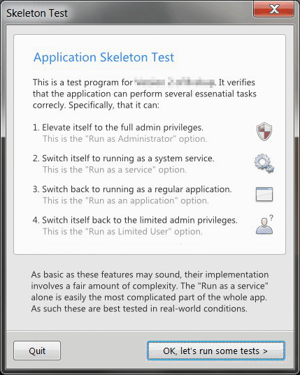

« Reply #15 on: November 20, 2012, 07:46 AM »
Ok, if you will forgive my very basic skills with Gimp, here is a quick edit of your dialog to see what it would feel like:
The changes I made are
  • Added a hint of color to the icons to make the dialog seem less bland
  • Removed the texturing on the background to make it feel more clean
  • Removed some vertical space -- the original was quite tall
  • Gathered the list items in one text box together with the text at the top, since they are not actual button choices

« Reply #16 on: November 20, 2012, 01:37 PM »
^ I *do* like that version better...  Although I liked the texturing, and would add that back.
« Reply #17 on: November 20, 2012, 02:08 PM »
I very much like the look of either. The first is certainly more "modern" looking, but the flat version works equally well. (I personally much prefer to see flat screen elements. No good reason for it really. I just prefer them.)
I would suggest, however, that since each of the choices is mutually exclusive, radio buttons be used? Thats what they were designed for. They restrict the selection to a single choice and make it explicitly clear which selection is either the default or is currently active,
The icons to the right of the text don't always make it obvious that they are buttons - mostly because so many other apps put so much useless 'bling' up on the screen that you're never completely sure what's clickable and what's not.
Not to say that you'd need to adopt the ugly and dated looking "black dot in a circle" standard radio button, (Although there's a lot to be said for it since it is a standard interface element most people are familiar with by now.) You could have the background color behind the selection change when you hover over it or something similar to provide a visual clue it was an active element. (Note: if you went this route, the first mock-up would look better since you already have borders around the text. So it should be relatively easy to use a hover effect with that design.)
Just my :two:
« Last Edit: November 20, 2012, 04:09 PM by 40hz »
« Reply #18 on: November 20, 2012, 02:14 PM »
It sounds like you did the same thing I did at first -- assume it was four buttons giving you a choice, like you see in some of the Vista+ dialogs. But I think it is actually just a static list of things that will be tested when you click the OK button, which was why I put them together in one textbox instead.
I could be wrong of course, maybe they are buttons?
« Reply #19 on: November 20, 2012, 02:29 PM »
^Precisely!  ;D
I wasn't sure either. (Which might indicate there's a design problem.)
But if it is a list of tests about to be run, something along the lines of the following might be clearer?
This will test each of the following four settings below to ensure correct operation:
..test
..test
..test
..test
Do you wish to run these tests now?"
<Yes - run these tests now. |  No. Just go back to previous screen>
8)

« Reply #22 on: November 20, 2012, 07:50 PM »
Paul, thanks for a thoughtful comment, but I'm afraid you got off a wrong assumption. This is not a program that is meant for repetitive use, it's a single-run disposable. It will go to the people on the mailing list, so it's probably OK to assume that whoever downloads and runs it would also have some interest to read through the explanatory text. With regards to the redundancy - I see your point, but I disagree. I am all for minimalism in the UI (see, for example, here), but this is not a place to overdo it.
Jibz, very good iteration, thanks. I ran this screenshot by /r/software (here) and the window being very tall was the #1 remark. I also have to concur that it looks rather nice without the texture. I had the texture put in first, and then added all other decorations. Never occurred to me to try and take it away.
40hz, Stoic Joker, f0dder - no, not buttons... but I suspect you suspect that already :)
In any case, I was looking to check if this sort of customization level is OK with everyone, and it looks like it is. So I got my answer.
Also, having slept on it, I am now reworking this particular proggy from being a "Test" into a "Demo". With this I can trim some text and simplify the layout.
Alex

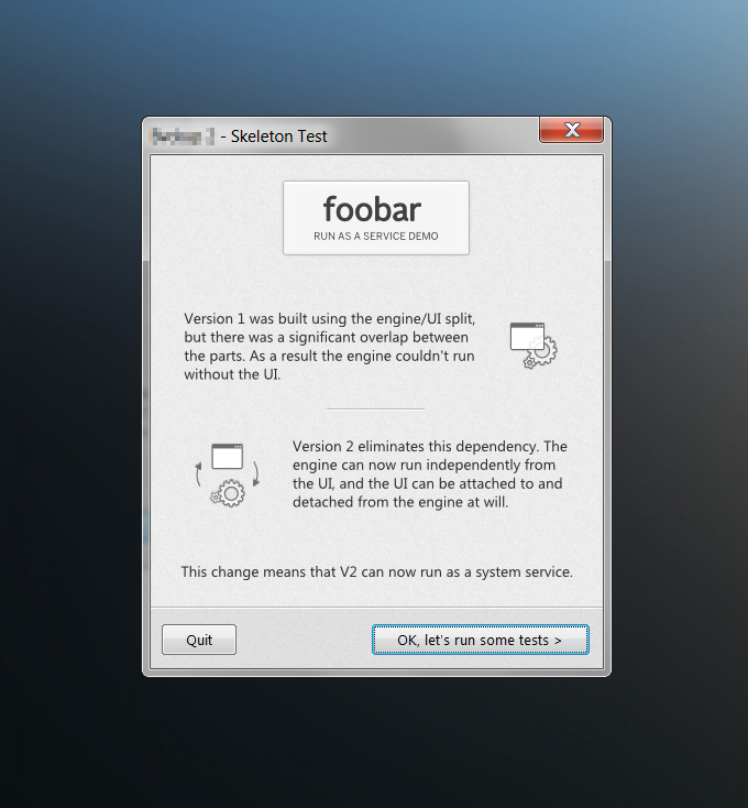

Alright, what about this sort of approach? Less decoration, more layout, more contrast and a bit more texture.
Alex
« Reply #24 on: November 21, 2012, 10:07 PM »
Apart from the texture, I think it's pretty fine :)
Perhaps a way to get some information on which tests are going to run, before pressing the button?
