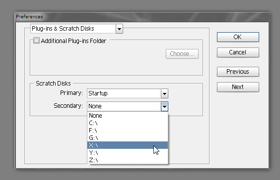

Sounds like a bug to me. You could try changing the 'Scratch disks' (Adobe's version of a pagefile). They seem to be pretty standard across the Adobe board.
THey're under Preferences. Here's what it looks like in Illustrator CS4 (Photoshop is similar - my ancient 1999 version has four scratch disks)
change them to a drive that isnt being used - preferably on a second harddrive

Thanks for the reply.  I have heard the idea about scratch disks and I'm looking into that now.
