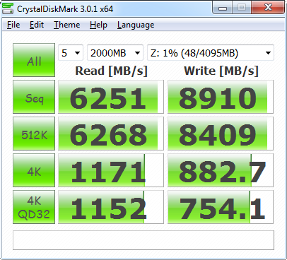

CrystalDiskMark 3.0.1 x64
5 passes, 2000MB test file
Test data: random (default)
...I'm not a super big fan of CDM, since it's weird and uses the silly SI units for MB - but it's easy to use, and what Raymond's benchmark uses.

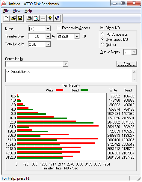

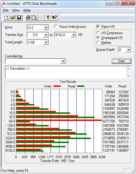

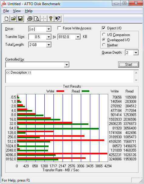

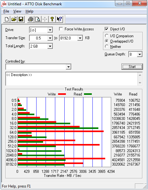

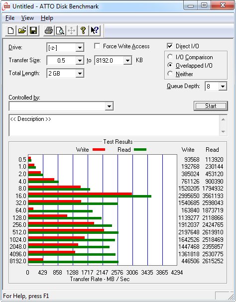

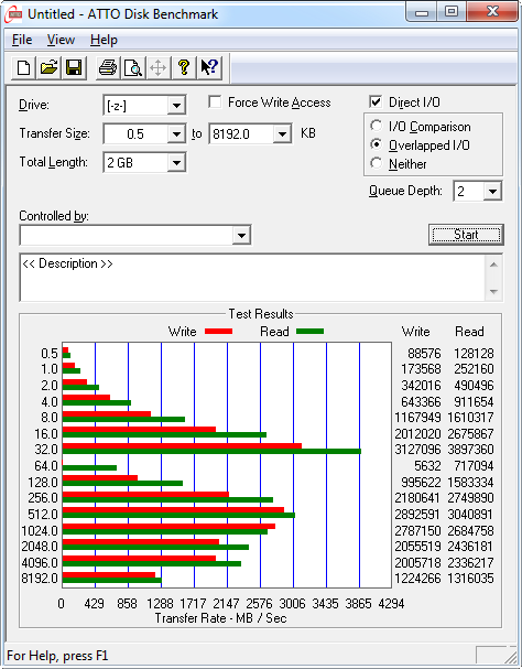

ATTO disk benchmark: 2.47 bench32
Direct I/O, Overlapped mode
transfer size: 0.5 to 8192kb, tested with queue depth of 2 and 8
total length: 2GB

SuperSpeed RamDiskPlus 10.0 x64
 Test : 2000 MB [Z: 1.2% (48.3/4094.7 MB)] (x5)
 Date : 2012/10/22 21:12:55
          Sequential Read :  6251.861 MB/s
         Sequential Write :  8910.925 MB/s
        Random Read 512KB :  6268.756 MB/s
       Random Write 512KB :  8409.925 MB/s
   Random Read 4KB (QD=1) :  1171.595 MB/s [286034.0 IOPS]
  Random Write 4KB (QD=1) :   882.728 MB/s [215509.7 IOPS]
  Random Read 4KB (QD=32) :  1152.307 MB/s [281324.9 IOPS]
 Random Write 4KB (QD=32) :   754.141 MB/s [184116.5 IOPS]

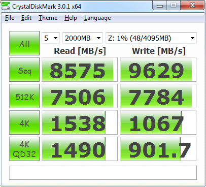

SoftPerfect RAMDisk 3.3.2 (2012-Oct-11) x64 - note that v3.3.1 from Oct06 changelog says "Major optimisation with performance gains 20% to 900% in various tests."
 Test : 2000 MB [Z: 1.2% (48.3/4096.0 MB)] (x5)
 Date : 2012/10/22 21:33:50
          Sequential Read :  8575.204 MB/s
         Sequential Write :  9629.429 MB/s
        Random Read 512KB :  7506.314 MB/s
       Random Write 512KB :  7784.935 MB/s
   Random Read 4KB (QD=1) :  1538.529 MB/s [375617.4 IOPS]
  Random Write 4KB (QD=1) :  1067.687 MB/s [260665.8 IOPS]
  Random Read 4KB (QD=32) :  1490.878 MB/s [363983.8 IOPS]
 Random Write 4KB (QD=32) :   901.656 MB/s [220131.0 IOPS]

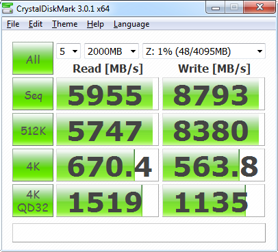

ImDisk 1.5.7 (2012-Jul-30)
 Date : 2012/10/22 21:56:39
          Sequential Read :  5955.938 MB/s
         Sequential Write :  8793.090 MB/s
        Random Read 512KB :  5747.944 MB/s
       Random Write 512KB :  8380.221 MB/s
   Random Read 4KB (QD=1) :   670.431 MB/s [163679.4 IOPS]
  Random Write 4KB (QD=1) :   563.793 MB/s [137644.7 IOPS]
  Random Read 4KB (QD=32) :  1519.625 MB/s [371002.2 IOPS]
 Random Write 4KB (QD=32) :  1135.113 MB/s [277127.1 IOPS]

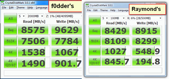

-significant difference between a couple of SoftPerfect's parameters; i.e. between your measurement and Raymond's. Do you have any idea as to why? Regardless of the reason, it is pleasing to see that this freeware did much better (in particular in two of the tests), than I first quoted it to be able to.
:up:
edited a few minutes after having posted:
oh, only now did I see your post about the update. Sorry!
-and even one more post about it. Hmm... I have some catching up to do!  :-[
« Last Edit: October 22, 2012, 10:22 PM by Curt »
Re: Smallish RAMDisk benchmark
« Reply #4 on: October 22, 2012, 10:36 PM »
f0dder's use of the x64 version may make the difference here ;)
/Ton
« Reply #5 on: October 22, 2012, 11:22 PM »
Dunno about the differences - that I have an x64 OS might matter somewhat (it has somewhat more efficient system calls and context switching than x86), that I run x64 CrystalDiskMark shouldn't matter much. We're probably using roughly the same speed RAM (same MHz, timing might be different but I haven't seen that matter that much in recent years).
Raymond doesn't mention which CPU he has, which does matter, since cache size and memory controllers differ - given that he runs DDR3 ram, I do assume his CPU is modern enough that the memory controller is on the CPU and not the motherboard chipset. He also doesn't mention NTFS cluster size, but that's probably going to be standard 4k, and I don't know how much that really matters, outside of how it affects fragmentation.
The most interesting differences are definitely in the 4k results. It might be something as simple as me having a faster CPU? (One core seemed to be maxed out during a fair amount of the test). At ludicrous speeds like that, and a small size like 4kb, there's probably going to be quite a few context switches per second :)
