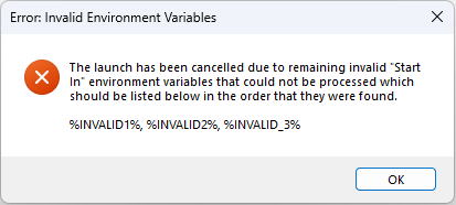

1. I have fixed in my local copy to where it should remove any sign of double quotes. (At launch phase)
2. Yeah it cannot handle environment variables like that in beta v2.1.0 b68 and previous but I have researched and made a small change to attempt to parse %userprofile% and others from the "start in" with no additional changes needed by you upon the next update. Also now checks to see if it still contains % after attempting to parse the environment variables and will cancel if still found after parsing what it can.
As for the last bit about caption I cannot tell it the space to use between icon and caption. Also make sure the \n isn't shown in the tooltip in button properties as I think in one beta it added them to the tooltip portion in a minor bug from the drag and drop as well and should be fixed though in current beta version.
Example of #2 when environment variables are parsed and the string still contains some that could not be replaced...
« Last Edit: May 15, 2024, 12:38 AM by hamradio »

  1. Added conversion of environment variables to the start in field (e.g %HOMEDRIVE%, %HOMEPATH% and others) when launched.
  2. Note on #1: Launch will be cancelled if it still has environment variables that could not be converted with a message that should display all the environment variables that remain invalid.
