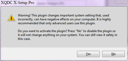

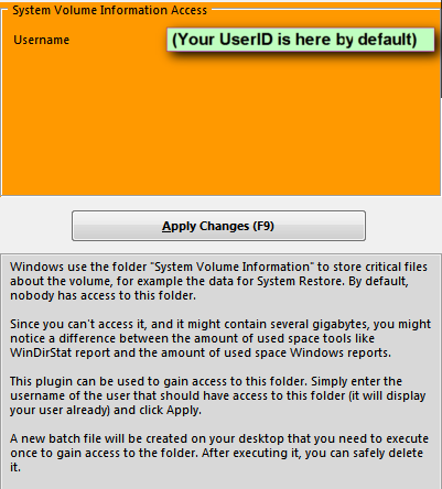

If you want to find this feature in X-Setup Pro v9.2.100, then you will be able to find it under Common Annoyances | System Volume Information Access. If you select it, it will give you a warning, and then the details as to what this feature does:
