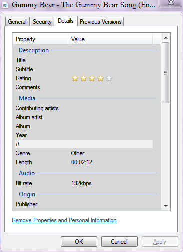

In Windows 7-64:
Right-click file for file Properties. The bitrate is shown in there.
You can also set Windows Explorer to file Details view, then add a column for Bitrate, so you can see the bitrate for every file, right there in the Windows Explorer window. (That's what I usually do when viewing my mp3/music folder.)

$spacedad: Sorry, I think I misinterpreted what it was you were asking about.
I confess to being stumped.
All I can find is the Alt+F3 hotkey in Winamp, and the file Properties in Windows Explorer

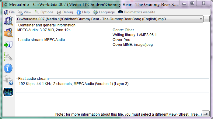

Ah! Found it! Media Info: http://mediainfo.sourceforge.net/en
It integrates into the Windows Explorer Shell. Right-click on an MP3 file, and you get:
(Sorry, I had this all along, but didn't realise until just now that it could integrate into the Windows Explorer shell.)

Yes, Windows Explorer in Details or Content view and with Preview is very informative, but @superdad seems to be wanting rather more info. than that - e.g., sample rate.
MediaInfo seems to give that and a bit more - e.g., channels. For example, see screenshot in my previous comment.

yes mediainfo works a treat,even gives the info as a pop-up if you hover your mouse.
i didn't know about that one,thanks a lot,much appreciate it! 8)
