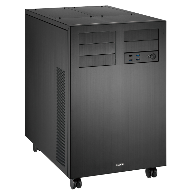

I like Lian Li's stuff, very nice.  So check this out, this is called PC-D8000 and it holds up to 20 hard drive, yes!  And it looks like it shouldn't be as loud as the normal rack stuff with the 120/140mm fans.
Looks like this will be my case then.

After a quick review of all the enclosures I could find, unless I fabricate my own, the Lian Li is the best one.  Why?  It's the most spacious of them all for 20 drives.  The other ones resort to 5.25 drive bays that cram 3-5 drives together really closely, which I'm guessing is bad for heat.  I feel I'll be able to get more effective air flow with the Lian Li.  Plus it has a lot of spaces for big fans.
I also liked Caselabs, but their innards would cramp the drives together more.  The enthusiasts seem to like it better, though.  But most of them were doing a couple of hard drives and big water cooling systems, which is different than mine.
I also checked out separate towers for the motherboard and hard drives, but there are none that can go more than 10 drives (without resorting to the drive bays cramming).  So i think I'm stuck with the Lian Li pc-d8000.

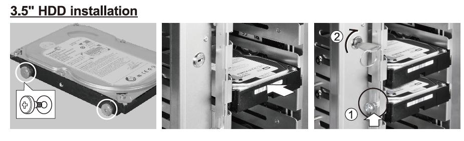

The Lian Li pc-d8000 has rubber washers around the screws holding the hard drives in place.  It's a good design, I like this company.

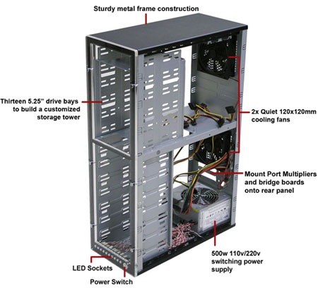

Addonics makes some pretty interesting large storage tower enclosures. Don't know much about them other than what I've read however.
« Last Edit: October 04, 2012, 05:20 PM by 40hz »
Re: Barebone server: what else do I need to complete it?
« Reply #38 on: October 05, 2012, 12:11 AM »

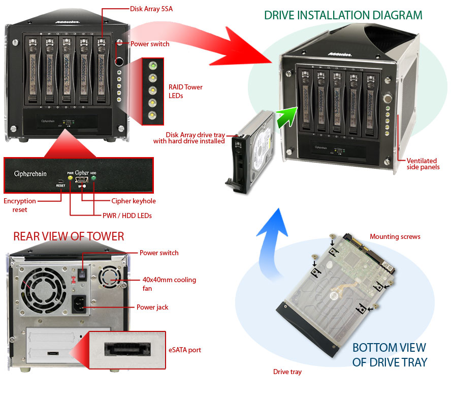

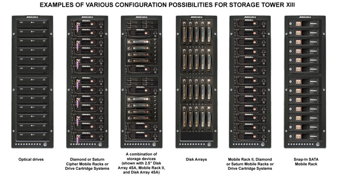

I was initially going to go for the XIII before I started this thread, since Addonics seemed to be the only company with any options along these lines.  I still like it, especially that it's narrow.  I'm guessing the Lian Li is better for airflow, so if that's available...I don't know.  Choices...
If I go for the modular approach, which I normally prefer...I can get a normal tower to hold the mobo, and one of these Addonics for just the drives.  I like that setup.  But you guys freaked me out about noise and heat!
So now I'm debating:
big fat Lian Li all-in-one
vs
Addonics XIII with 20-disk array, and separate tower
I'm leaning towards the latter.  I first want to check the fan setup on that tower, see how many, what size, etc.  More portable also.  You know, I'll call them about the noise issue.

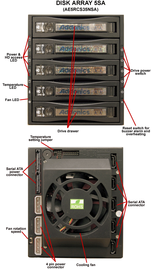

(A couple of cool pictures for myself), this is turning into my personal research thread!

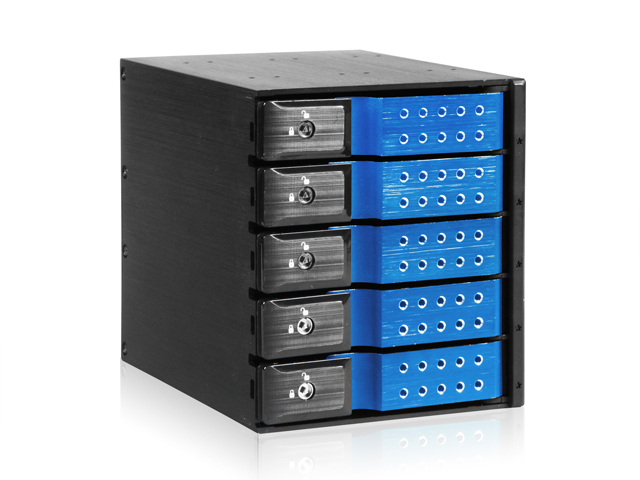

Well, iStardock has perhaps another model to consider:
http://www.istarusa.com/istarusa/product_speclist.php?series=HDDCage&sub=SATA/%20SAS
What interests me is the trayless design.  I know I won't be swapping out too much, but why not get the feature if it is easier?  This particular model is made of aluminum which is better than plastic for the Addonics.  Any opinions?
Link to in-depth review
Note: this review is for another similar model, but I don't know if it's the better model.  I think it may be the more updated model, but the picture above is the all metal model, which I probably prefer.
regarding noise:
On powering up, the noise from the fans in the top cage was very noticeable - not unpleasant, but definitely there.  Whereas I normally have to be within three feet of the machine in order to hear any noise, I can now hear it from 15 feet away.  Once a movie is playing, I doubt that I would be troubled by the noise but the perfectionist in me wants to eliminate it.
« Reply #41 on: October 09, 2012, 06:30 PM »
Here's what I have so far:
Tower:
Addonics RAID Tower XIII
  • Only pure hard drive tower available in the US market from what I could tell.
  • Need to find out if I can buy it WITHOUT their drive bays; just the tower
3-to-5 drive bay conversion:
iStarUSA BPN-DE350SS
  • Only all-metal option out there.
  • 80mm fan vs. 60mm fan for cheaper alternatives.  However, one (plastic) model from SuperMicro supposedly has 90mm that are extremely easy to replace.  Still, I think I prefer all-metal construction over a slightly larger fan.
