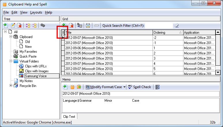

Click the thingy there:
Then check "Ordering":
Then type the PRIORITY in the "Ordering" column (shown in first screenshot above). That is, the priority towards the top of the context menu, i.e. higher numbers go at the top, while lower (or negative) numbers go at the bottom.

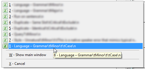

Oh, I should post this too:
There you can see that my "-2" priority is there at position #8 at the bottom. It's the same entry as you see in the screenshot above.

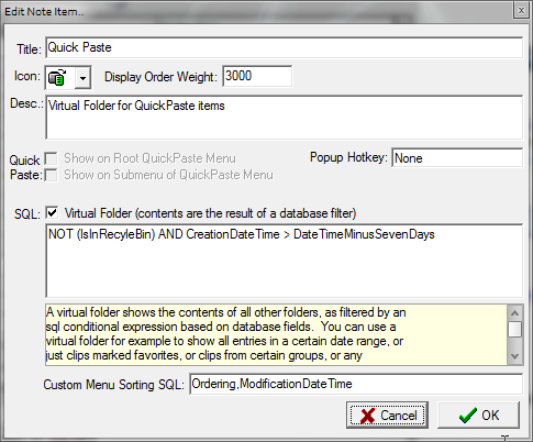

For the record (still on-topic)
I believe (but not 100% sure) that the default sort in the pop-up list involves moving a pasted clip to the top of the list (i.e. sort by last use). This is dictated by:
In the CHS window, right-click on the folder and click Edit this group.
Down the bottom are the sorting criteria:
Re: How to order clips in menu of virtual folder?
« Reply #11 on: September 07, 2012, 09:24 AM »
I find the SQL stuff all very confusing. There's nothing in the help file to explain it.
Looking at the "Custom Menu Sorting SQL" field, I have this:
Ordering,ModificationDateTime

Just modified the 'Custom Menu Sorting SQL' option at the bottom of the 'My Favorites' Group to this:
"Ordering DESC,ModificationDateTime"
and it works; records with a smaller 'Ordering' value appear first with higher values appearing next
