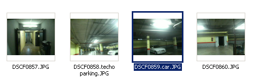

I usually have to rename audios and photos in a certain way....
I need to do individually because the subject is different.
This is my problem :
suppose the name file of the photo is :
I need to edit the way quickest with the cursor just at the end of the original name. Add the comment and enter.
So I need a soft able to do this with a definable shortkey.
If the soft exists I try first here . if don't exist I'll try in the snacks section.
Best Regards
