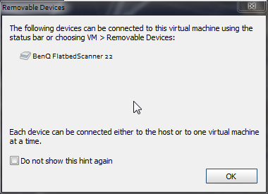

If I connect printer or scanner etc, I get this message (note: in a win7 frame):
I dont need them yet (I actually have my scanner, printer, external HD on a seperate extension lead that is normally switched off until I need one of them) but it looks like that's an either/or choice (I mean it will only work for one OS at a time) - and I'm wondering: how this works, especially if you need to swap over and back between the real and virtual machines.
