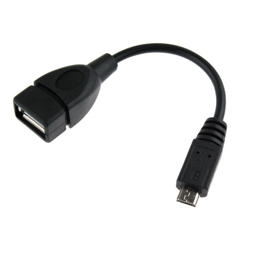

if you have an On the go (OTG) host cable, you can plug the receiver into your Android phone and listen to music and audio books. basic functions like play/pause and volume works.
OTG host cable

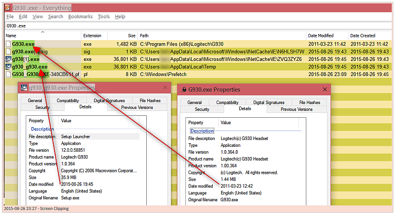

Re: Logitech Wireless Gaming Headset G930 - updating the software.
« Reply #37 on: August 26, 2015, 12:23 PM »
@Deozaan: That's odd. Maybe you are not using the latest Logitech G930 software? I don't have any file such as Device_Manifest.xml in any directory, related to G930 or otherwise. So I guess it's the Logitech gaming software that has this, not the standard G930 software. I don't have the gaming software installed.
Thinking I might have old drivers of G930 software, I checked.
The Windows 10 Device Manager showed that I was running the G930 driver v10.0.10240.16384 (2015-07-09), and when I got it to check for updates, it said I was using the latest version.
The G930 software interface did not display what version it was, but it did say that there was a newer version of the software available (right-click the G930 Systray icon to check for updates), so I let it download/update itself. However, the driver remained unchanged.
The image below shows that the installer (g930_g930.exe) updated the G930.exe software to a 2011 version (v1.9.364.0).    :tellme:
When I right-click the G930 Systray icon to check for updates, it now says I have the latest version. Still no Device_Manifest.xml in any directory, related to G930 or otherwise.
« Last Edit: August 26, 2015, 01:15 PM by IainB »

...As someone who did install it, it's no different that what you have in the G software.  You can install the G930 without installing the complete gaming bit, but the gaming bit integrates it in if you install that.
______________________
Yes, that probably helps to explain it.
The G930 headset software switches the headset off after X (approx 10 or so) minutes of continuously having detected no sound input.
The tweak that @Deozaan describes is to the file Device_Manifest.xml, which is apparently set by default to switch off the headset after a specific period of time (15 mins.). What an annoying setting! - but I would presume it's a mistake (human error).
It seems that the file Device_Manifest.xml is probably installed by the gaming software (which I haven't installed).
And just for clarity's sake, mine does do that in windows 7.  So if I use the headset as just a headset in mumble or ventrilo, if we're not talking, it will shut off.  But if I route my game through it also, it never shuts off.  I've just dealt with it.
