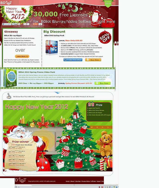

I've found this works well:
BDlot DVD ISO Master
I don't know if BDLot are maintaining their programs, but they surely aren't maintaining their site
- or maybe they merely confused Seasonal with SeasonAll:
The Christmas tree let me win 3 programs!,
until I realized they should have been registered half a year ago...
I don't think Feb this year is all that out of date for a free decrypter. That's the latest release I'm using. If you want latest greatest to decrypt against new blockbusters you'll probably have to pay. If you want to rip DVDs that have been in your collection for years this app in combination with DVD Shrink will do the job for most of them.
edit: Also it's good to look here:
http://www.videohelp.com/
You can find things no longer available other places. For example the author of Imgburn is proscribed from hosting DVD Decrypter that he wrote. If for some reason you still have a use for this old app, such as other no longer developed tools that expect to use it, you can still download it from videohelp.
