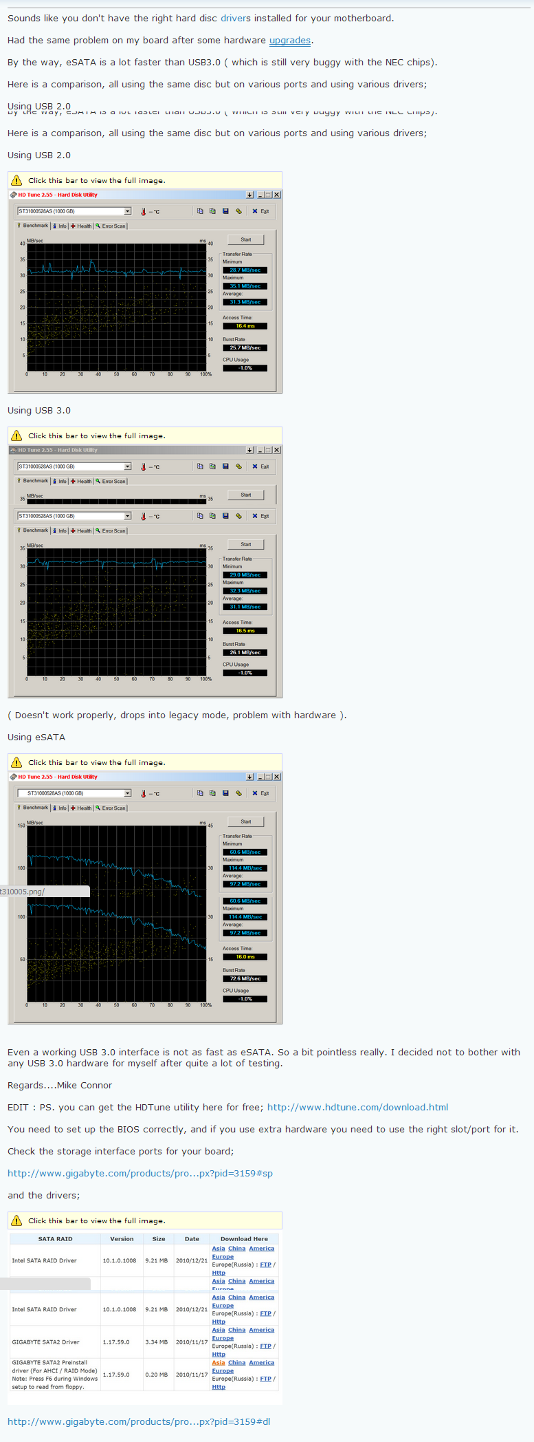

Found a thread that talks about some tests performed on usb and esata.  His tests show very clearly how esata is faster and more reliable than usb 2 or 3.
Thread is here:
http://www.sevenforums.com/hardware-devices/135680-usb-3-0-extremely-slow-transfer-rates.html
By the way, eSATA is a lot faster than USB3.0 ( which is still very buggy with the NEC chips).
Here is a comparison, all using the same disc but on various ports and using various drivers;
Even a working USB 3.0 interface is not as fast as eSATA. So a bit pointless really. I decided not to bother with any USB 3.0 hardware for myself after quite a lot of testing.
