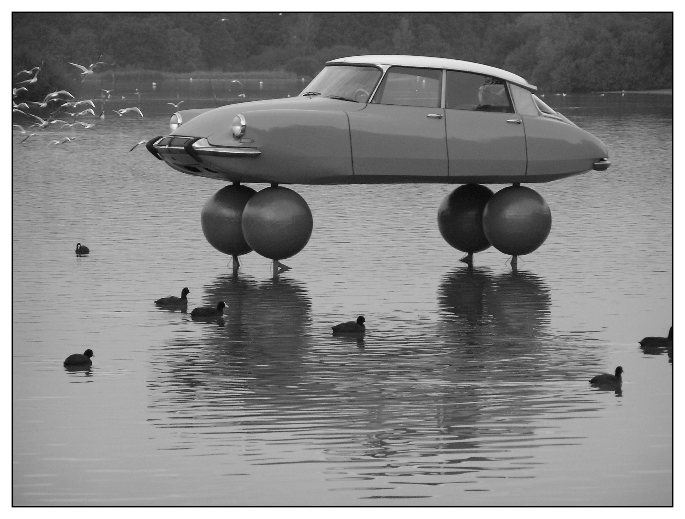

Obviously this photo began life as a colour picture, and only then was converted into black & white. But it is a mystery to me how Explorer and several photo editors can display the thumbnail in colours. Of course the photo is b&w when I open it, but even when copied, the new thumbnail is still in colours. I wonder if a photo somehow is carrying a thumbnail photo of itself? I have never seen this before - but of course I very seldom have any black & white pictures. Actually, in this case as in most cases, I think I would prefer the colourful "orange" version ;-)

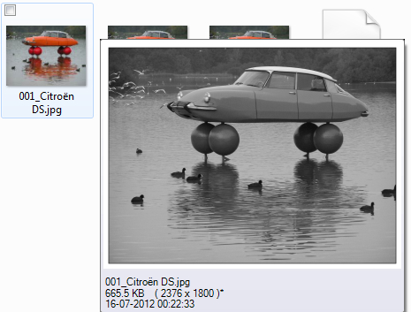

The thumbnails in "Large icons"-view In Explorer (big b/w pop-up thumbnail created by QTTabbar):

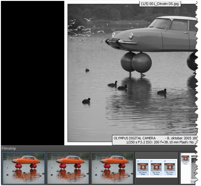

As seen in Zoner 14 PRO photo editor (the "orange" photos are the thumbnails of 3 b&w photos):
The actual photo (click to enlarge):

The metadata inside of some image formats contains a thumbnail (or stamp). This information is entirely separate and distinct from the actual image itself, but is formed when the photograph is taken.
Not all editors deal with stamps (thumbnails) or not all editors deal with them properly.
When I wrote the Super Simple Photo Resizer, I came across this issue, and instead of simply not dealing with it, in at least some case (IIRC) I delete the stamp/thumbnail from the image file entirely. There are very good reasons to do this...

Re: How can a b/w photo's thumbnail be in colours?
« Reply #6 on: July 16, 2012, 07:40 AM »
Oh - don't forget to check the "thumbs.db" file as it can contain cached data. You can safely delete that. If you've deleted the EXIF data, then the stamp is likely gone, but still in the thumbs.db file.
