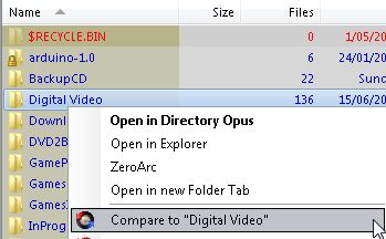

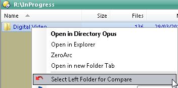

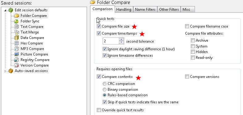

In Beyond Compare, uncheck the items below and it should only compare file names:

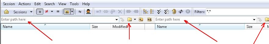

I set up Beyond Compare as you suggested, to hopefully focus ONLY on file name difference.
There is no "GO" button.  How do I get the Beyond Compare process started?

Compares as soon as it has two folders entered.
Or you can use the Context menu.

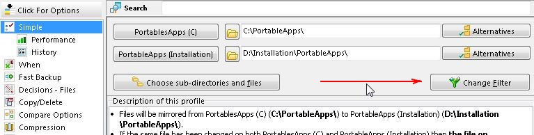

Check the Filters - there are default files/folders that SyncBack doesn't copy because it's ephemeral data, thumbs.db is one of them.
