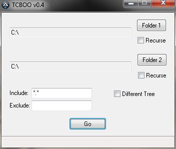

Re: DONE: Are any of the files missing???
« Reply #7 on: June 26, 2012, 11:22 AM »
TCBOO - output will open in your default text editor, where you can view or save it.
TCBOO = There Can Be Only One   :) (In honour of TaoPhoenix)
Only files that exist once will be listed.
The interface is self-explanatory, tool tips for everything of interest.
Caveats:
  • It can, in theory, only handle about 16 million files but I still wouldn't like to wait for the output.  Technical reason: Array limits.
  • It uses strings for the comparison, maximum string length is ~2 Giga-characters - which is a lot.  However, if you're are doing a lot of really deep nested files, then this limit may be exceeded but it would really have to be a lot.
  • Source code is messy and uncommented but hey, that's the way I like it.  Technical reason: It keeps my brain active.
Update (starting at v0.4 which was a fairly large rewrite):
  • Comparison speed has increased due to skwire pointing out a rather simpler way of doing things - thanks skwire!
  • You can optionally exclude the folder tree, (relative to initial path), from the comparison
  • Filters and Folders are written to an ini file, (same name as executable), when you exit
  • It works for network shares, (ie. really hacky mod that stopped it is no more)
Update (v0.5)
  • Uses a much faster sort routine.
Differences from previous version:
  • It only looks for and removes from the output, files that occur in multiples of 2 - I had over-engineered the previous versions to remove any file that occurred 2 or more times, as skwire kindly pointed out  :-[
    eg. So if a file exists 3 times, it will appear once in the output.  If it exists 4 times, it won't appear in the output. (Dependant on Different Tree setting)
How much faster is it from the previous version?
On my computer, (3.3GHz x6):
Previous version: 54548 filenames in 281 seconds, (HDD uncached read)
Version 0.4:        54550 filenames in 5 seconds, (HDD cached read)
Version 0.4:        253350 filenames in 63 seconds, (SSD uncached read)
Version 0.4:        253350 filenames in 28 seconds, (SSD cached read)
Most of the time is spent getting the file lists as from v0.5.
« Last Edit: July 24, 2012, 07:03 AM by 4wd »

Mea culpa....I didn't realise the progressbar is virtually useless with large numbers so I've removed it and just added a statusbar that spits out the numbers as it progresses.
Also made each folder individually recurseable, (Am?), and will add a button to stop the process, (or change the Go button to Stop).
Update :up: thatta way

Update up there:
  • Full filename and path are listed in sorted output.
  • Time taken display.
  • Added Exclusion filter.

I'm back!
Update:
  • It got faster :)
It's gone from this
  • 14003 comparisons
  • 291 seconds
  • 12% CPU
to this:
  • 54548 comparisons
  • 281 seconds
  • 1% CPU
It even found the eight files there was only one of  :D
I think I'm going to stop while I'm ahead.
It's up there.

So, the use of the word "suppress" is correct, and the concept is logical, but it's the logic of a coffeed-up supergeek in a 3 AM coding session.
Update up there.

UPDATE (v0.5) here:
  • Using a much faster sort routine.
@nkormanik:  Using the file tree you sent me, it was taking a ridiculously long time to sort the list, (I gave up waiting), so it may have failed because of something in the old sort routine.
New version goes through ~368000 files in about 10 seconds on my computer.
