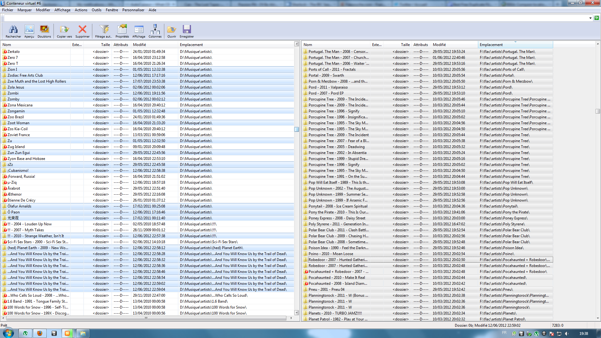

ZTreeWin can do this regardless of the folder contents, it can compare only the folder names. You'll need some of the beta version though (the new final release will be available soon), which work with the directories.
Here you can see the results after the comparison. The blue lines means that the folders are "tagged", so you can do any global operation with them, like deleting, moving, or renaming.

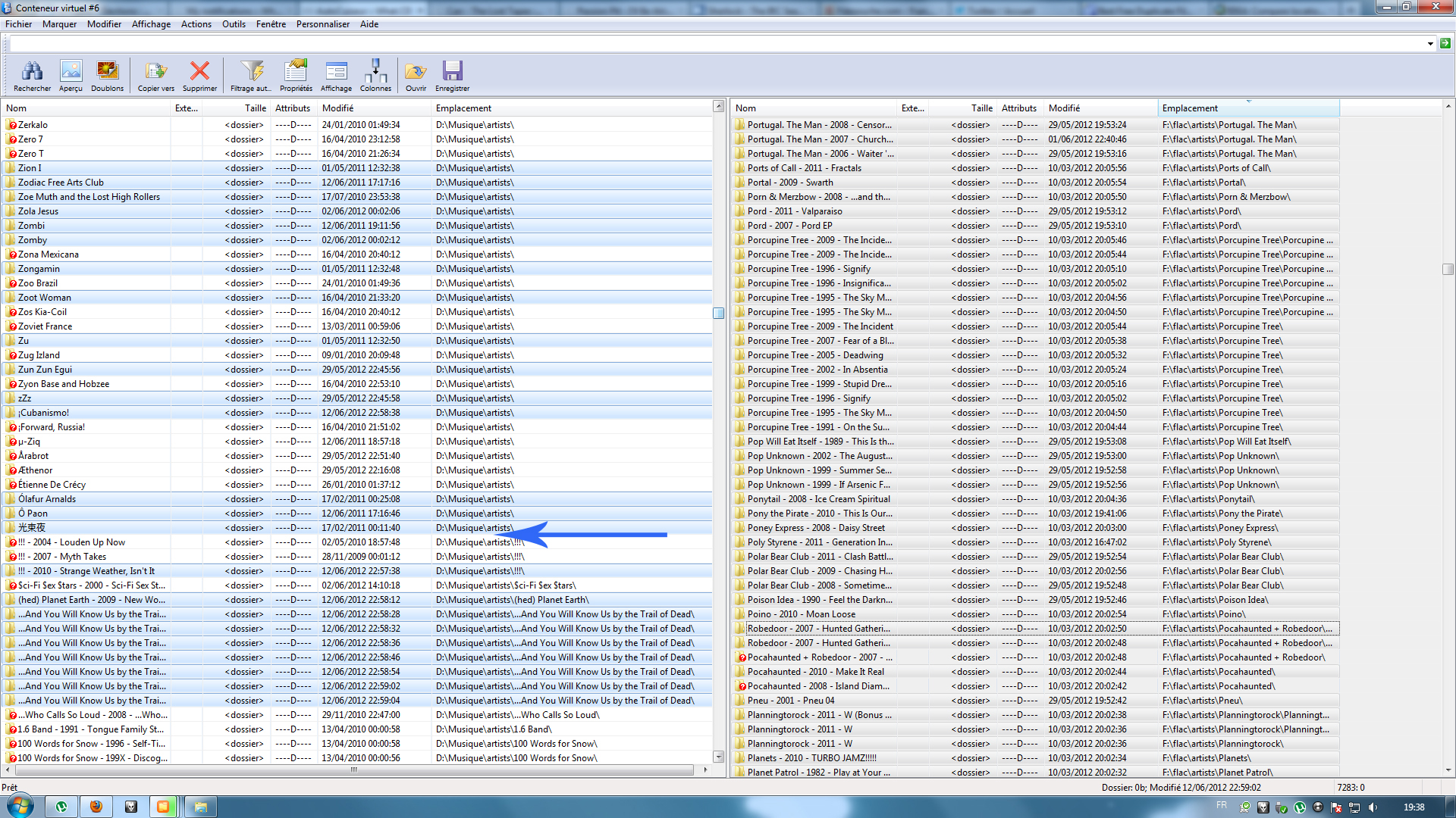

Yes! It looks very interesting in regards to what I'm looking for..
I'd like to compare folders "A" and "B", and I cannot find how in the example bellow:
It says directory empty with the "Compare" function
yksyks

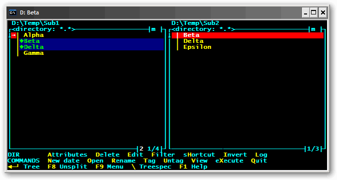

First, you're right, there's a problem with directories with no files in them—I've just reported this to author.
Second, to compare the directories, you have to sWitch to Directory mode (press W, and on one side is enough), because you don't want to work with files, but directories only. Then press Enter to display the contents. Then Alt-F4 for compare, then Enter, and key "I" repeatedly until you reach "tag: Identical (name )". That should do, provided the relative roots contain any files. This for sure will be fixed soon, the author is very active in fixing problems.

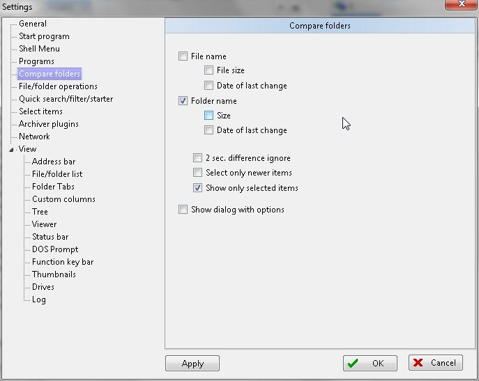

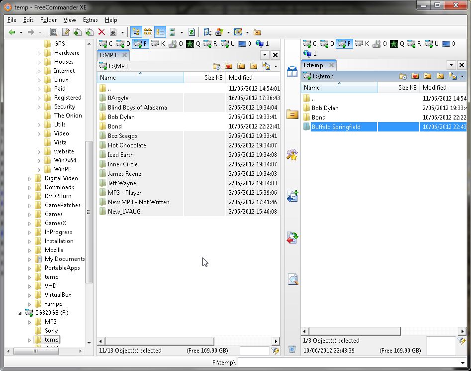

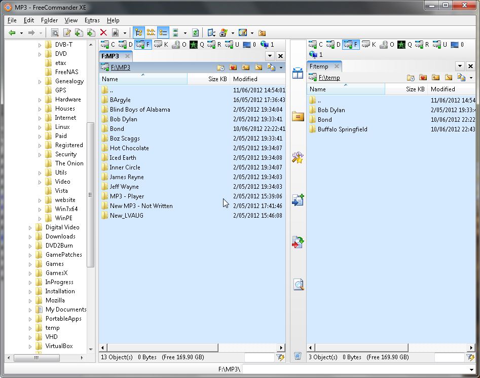

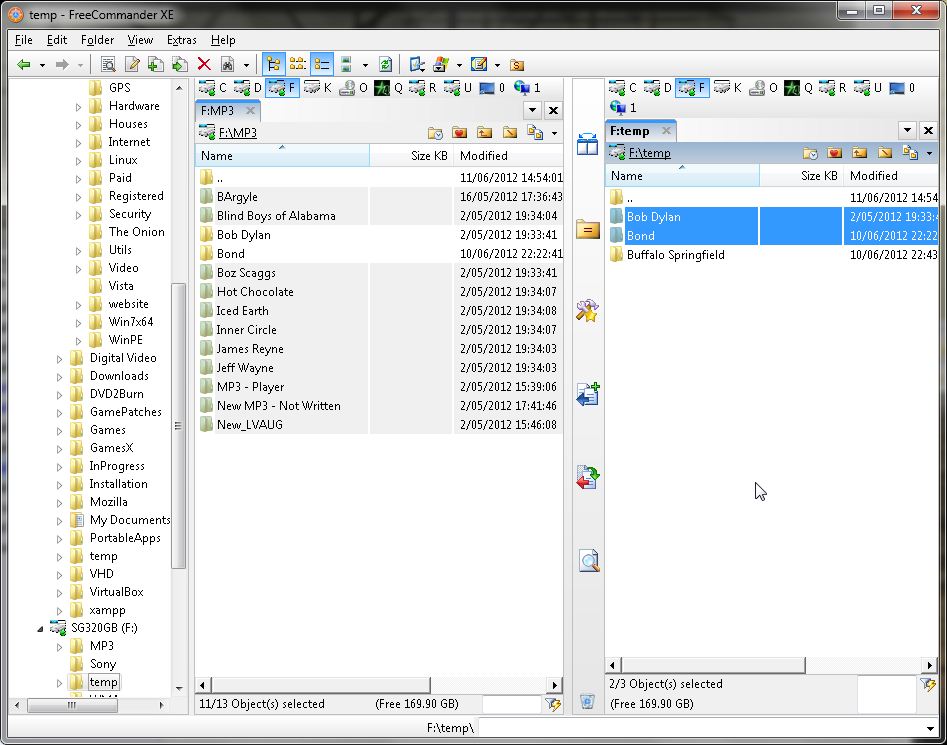

There's also FreeCommanderXE, (which looks better IMHO :) ):
Open Extras->Settings->Compare Folders and choose your options:
Navigate to the folders in the Left and Right pane:
Select Folder->Compare (Alt + V by default) and the folders that are different will be highlighted on both sides but only the right side will be active:
Select Edit->Invert Selection (Num * by default):
Then you can delete, move, etc.
