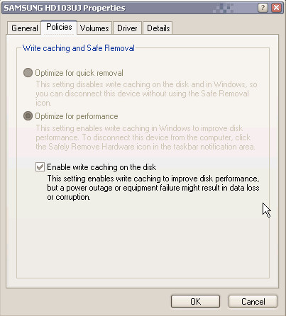

That doesn't sound like the Disk Write Cache, that sounds more like they don't have a program that does auto-saves every x minutes, (or that they are not saving the data every so often).
You can go into the Device Manager->Disk Drives and then right-click to open the Properties window for each drive, then go to the Policies tab and turn off Enable write caching on the disk.
This will at least enable you to test whether data is still lost after a few hours - if it is, then you have another problem.
You should also check the Event Log for any disk related errors or warnings, (eg. Delayed Write Fail).
