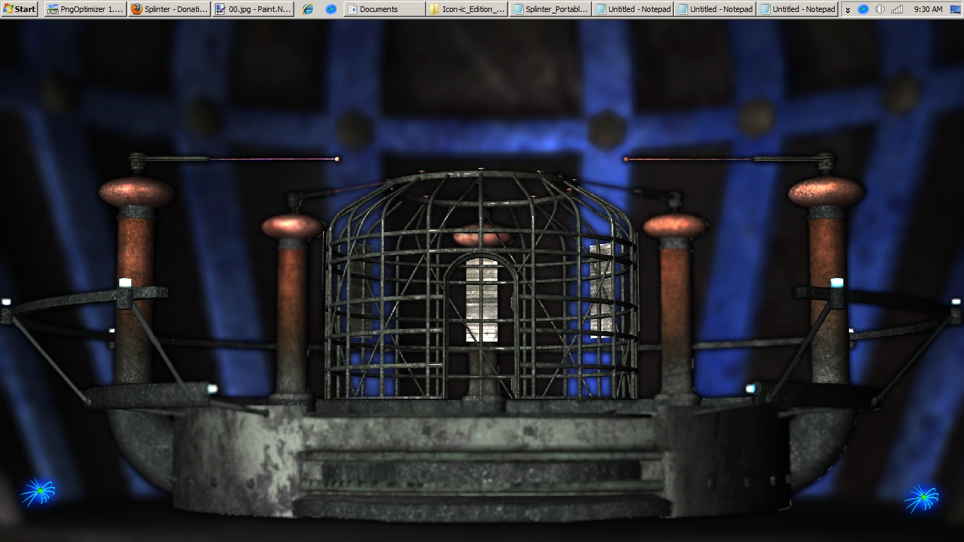

Make this the wallpaper and it should line up with the triggers that are hidden
Re: Splinter
« Reply #51 on: May 05, 2012, 04:39 PM »
Okay, time to put my Pest Hat on.
I added that wallpaper.
No amount of hovering or clicking anywhere near the "Nuclear Orbs" does anything.

HAHA, OKAY, I WILL SET MY SCREEN REZ TO 1360 AND RESEND.

anyway, this is same one, just with triggers showing. posting now. but when file uploaded and posted, i will come back in and edit in order to tell you how to hide the triggers again
K, so just right click a trigger, go to properties, then appearance tab. set opacity to 99. click okay and they will fade out. that is it. click left one first, then right, to see splanime

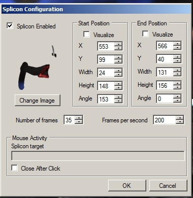

WAIT, HERE MATCH THESE SETTINGS FOR THE RIGHT SPLICON, IN ORDER TO SEE A BETTER SPLANIME
THIS is what splanimation is. The art of making a still image, simply OPEN, based on three sets of variables for both starting and ending locations, and making it look similar to pre-recorded, frame by frame animation. This isn't a perfect example, but it is still cool and only can get better. This is MY favorite part of Splinter's "entertainment' side
Re: Splinter
« Reply #55 on: May 05, 2012, 04:53 PM »
Getting closer! But do you mean "transparency" at 99%, not "opacity"? It's like you have them backwards!
Meanwhile, how do you set any of that to opening a folder?
And I also found a bug. Let's say that the correct order is Left Trigger then Right Trigger, after I have clicked the right trigger and then the left one a second time to "put here away", I am left with an arm in mid air, and if I click the right one first (should do nothing) then an arm appears out of mid air.
Edit: I put the new settings in, I do think it looks better.
Ya, backwards. I'm movin a mile a minute....Open a folder. Drag the folder onto either the trigger or the splicon. That is it. Drag and drop, with Splinter.
And that isnt a bug. I didn't create a script set. I just did what you asked. I will post in a few minutes the text to copy paste into the script tab in order to do what you say. (Right now they are simply triggers opening splicons. there is no scripting or code of any type happening)
Thanks. Too easy, with the scripting, right?
Actually, I was foolish to have her sword appear over the blue part, initially. Without the blue being needed to match, the splanime woudl be seamless, almost impossible to tell apart from animation.
And always a good idea to adjust the number of frames, to see how your pc handles it. May be way different than mine.
