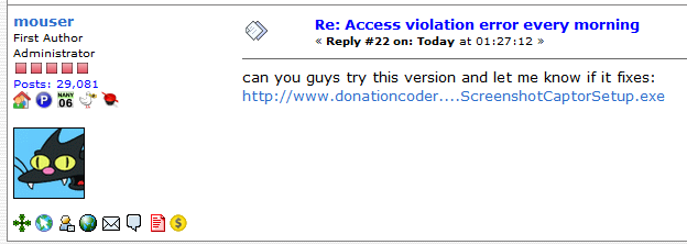

« Reply #22 on: June 18, 2012, 11:27 PM »
can you guys try this version and let me know if it fixes:
[beta link removed -- new release is officially uploaded]
