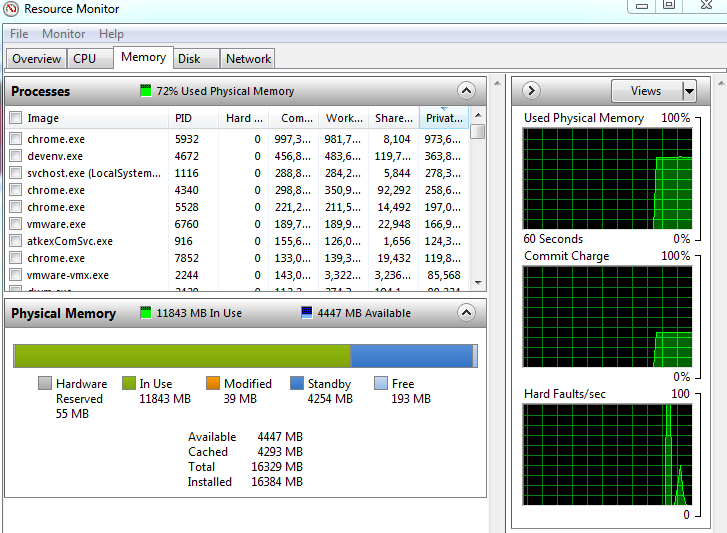

Of course that screenshot changes the moment you switch back to that Chrome instance (tab) and begin using it ... as most of that paged out virtual memory is reloaded into RAM.

I do not mean to be disparaging. Indeed virtual memory management is more complex than I've even laid out here, and is often misunderstood by developers and end users.
I would like to add one thing, a 'visual' screenshot of the Windows Resource Monitor's 'Memory' tab. Notice it shows 'Hard Faults/sec' as an important metric. That is because it represents, as I tried to write above (like I said, I write terrible), that ideally the fewer hard page faults your system incurs, the better. These are page-in operations. If you run your tool every 15 seconds, you should see this metric shoot up as a bunch of pages are pulled back into memory as they are referenced. The *only* thing that may mitigate it some is that a few page faults (page-in operations) may be in the active disk cache, and thus be a soft page fault. These are not shown here (though you can see them elsewhere).
