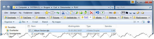

On the process line I see the shortcut to Explorer > Libraries. It is clearly a limited rights -version. This is my first problem. I have no guest accounts, I am The single user Administrator, so how on earth can it be that this Explorer doesn't give me an administrator's rights?
I have QTTabbar installed. When I open one of the folders I have made shortcuts for in Explorer via QTTabbar, I have elevated rights. But never when I click the default Explorer shortcut in the process line. I have tried to remove it from the process line  and pin a new shortcut, from a situation when all tabs were made by QTTabbar (and as such should give me Admin's rights), but the shortcut turned out to open a "normal" less rights -Explorer, not the QTTabbar version with elevated rights I was hoping for.
What have you "single-user-administrators" done? Did you shake you shoulders and gave in?
Or are any of you  genuine Administrators of Explorer? If Yes: How?  :tellme:
FYI:
Explorer with ten QTTabbar -tabs:

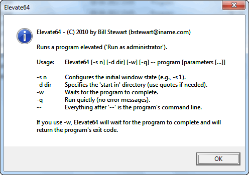

I found elevate32 and elevate64 (from http://www.westmesatech.com/index.html), maybe those will work for you.  They're in the Elevation Toolkit under Misc Tools.
« Last Edit: April 09, 2012, 07:38 PM by x16wda »

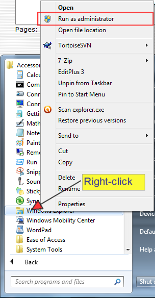

is there a shortcut-way of starting an app as admin from the start menu -
Ctrl+Click, or something like that?
Right+Click, select Run as Administrator.

Re: HowTo open Explorer with admin rights?
« Reply #6 on: April 09, 2012, 10:09 PM »
I found an answer, but it is both a little difficult and dangerous: http://social.technet.microsoft.com/Forums/en-US/w7itprosecurity/thread/1798a1a7-bd2e-4e42-8e98-0bc715e7f641/ so I am not going to try it yet.

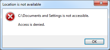

I #imagine/think# that the folders I was denied access to, really doesn't exist! I now think they are leftovers from the previous OS, a 32-bit Vista system. But I have deleted what I could find from Vista, when there were no more private files to recover, so these system folders are empty, because they link to something I have deleted. I #guess# this is why I am denied access; it is not as much a question of rights, but a question of me requesting Explorer to open something that really doesn't exist. As an example: to my understanding, "C:\Documents and Settings" is not a part of Windows 7, but surely must be leftovers from XP > Vista?
So maybe I can now be cool about this little weird problem of mine; it doesn't exist!
« Reply #14 on: April 10, 2012, 04:41 PM »
The seemingly hidden folder [C:\Documents and Settings]  on a Window 7 Drive is part of Windows 7. It's a virtual link that transparently redirects legacy software to the new [C:Users] directory.
Best not to fiddle with it... :)

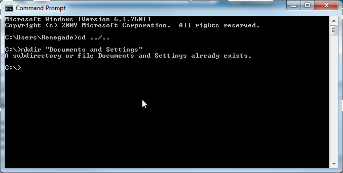

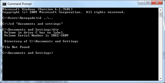

Sometimes Windows is just bucket loads of stupid...
Pasting "C:\Documents and Settings" into Windows Explorer results in:
BUT...

Right, because Documents and Settings is an empty target (e.g. Link). It's not supposed to contain anything, it just a way to get somewhere else. If you go to C:\Documents and Settings\%UserName% however, you will get a file list of that folder. Because it is a folder. D&C isn't.
« Reply #18 on: April 11, 2012, 01:04 PM »
Yeah, but it just strikes me as a bit crazy to return the bare bones instead of using it more like a pointer to the actual resource. Like, if you're "at" "Documents and Settings", why not simply treat it exactly like "Users"? i.e. Treat it exactly like a pointer.
i.e. When you go to "C:\Documents and Settings\", under the hood you are actually at "C:\Users\".
Like, this is just dumb:
The error message there is WRONG. "Documents and Settings" isn't a file and it isn't a subdirectory. It's a half-assed symbolic link.
Sigh... Anyways, that's just sort of explaining a bit of the reasoning behind why I find Windows so utter nutty sometimes.
