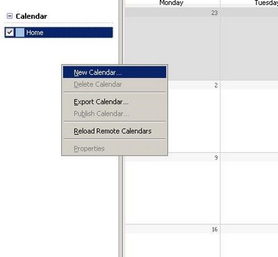

Using your mail client (I used Thunderbird for my testing and it does seem to be the easiest way) you can create a new calendar on your server:

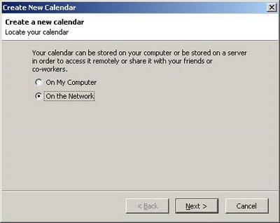

Make sure you say it's on the network:

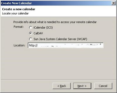

And it's connecting to a CalDAV server:
The address to use is as follows:
Code: (generic)
http://<your server>:5232/<yourname>/calendar
