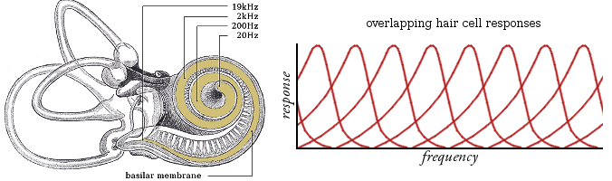

Because it runs counter to much of what I "just know" about audio, I took the time to experiment with sampling rates and do some critical listening over the last few days. Apparently I'm not alone in misunderstanding what I "know" about sampling rates:
Sampling theory is often unintuitive without a signal processing background. It's not surprising most people, even brilliant PhDs in other fields, routinely misunderstand it. It's also not surprising many people don't even realize they have it wrong.
