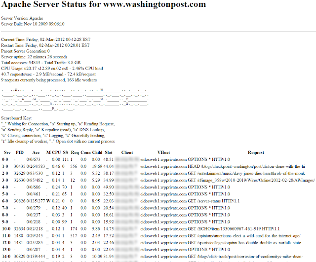

I describe this all on my blog. Basically, the default Apache configuration includes mod_status (a 'base' module, meaning statically linked by default), and many server admins don't bother securing it. This means all client IPs, and their server requests, are being revealed in real time to anyone who wants it.

Apache sets a bad example, with both Apache.org and PHP.NET both being wide open. hXXp://php(dot)net/server-status or hXXp://apache(dot)org/server-status . Wired is even open, at least some of its servers. It depends on which one you hit since they are load balanced. It seems about half of them are 'open', the other half properly secured.

Indeed, but would you believe Wired.com and WashingtonPost.com are vulnerable? That's insane. And I just checked a handful of sites off the top of my head. Again, Wired.com is load balanced, so only a percentage of its servers are affected (and it could even be fixed now).
Like I mention, Apache.org sets a terrible example, with their sites wide open. PHP.net, which I checked on today's 5.4.0 release of PHP, is also wide open and reveals they ironically are still running extremely old versions of Apache and PHP, lol.
