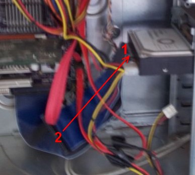

As SJ said further up the thread, there's 3 connectors on a normal 80 wire IDE cable.
BLUE - Motherboard end (might be green but the following two are standard)
GRAY - Slave device (connector in the middle)
BLACK - Master device (the other end of the cable)
Currently, the Maxtor is plugged into the gray connector.  Because it has been strapped as the Master it should be plugged into the black connector, (ie. the connector at the end of the cable).
It's picture time:
Unplug connector 1, (the gray one), then plug connector 2, (the black one), into the Maxtor.

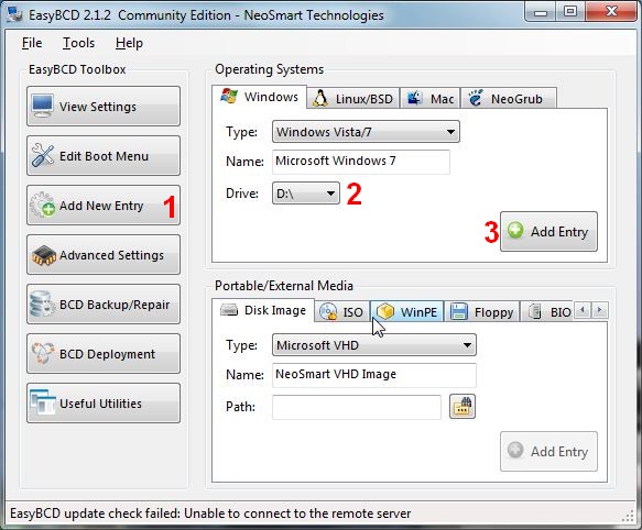

You can set the BIOS to normally boot off the Seagate and then run EasyBCD and add an entry for the Win7 installation on the Maxtor:
As easy as:
1) Select Add New Entry
2) Select the drive letter for the Maxtor
3) Add Entry

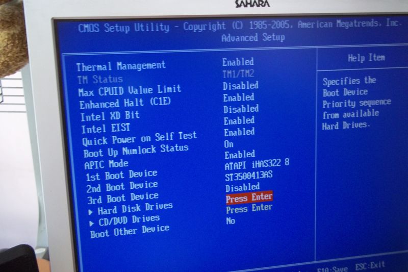

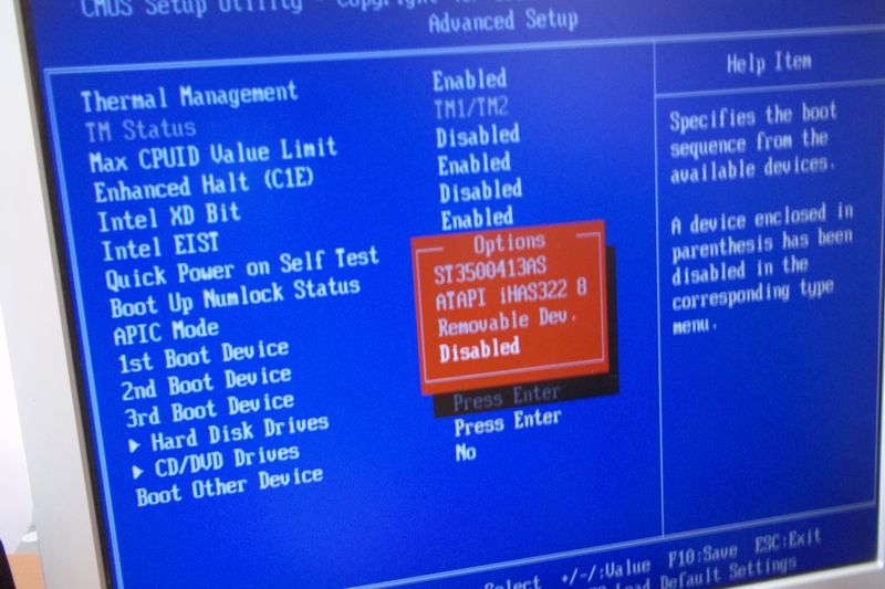

Have amended EasyBCD so my 'old' install is default and skips boot menu (for now) - nifty program  :Thmbsup:

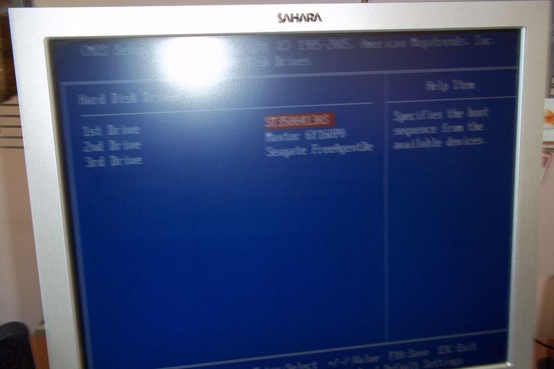

Here's pics from Bios:- Everything works but.......... Maxtor doesn't appear as a bootable device (pic 2) and can't change? (pic 3)
Excuse the blurry pic...
If you need help - JUST ASK!
Re: I Need DC Input
« Reply #86 on: March 04, 2012, 09:41 AM »
Because you haven't set it as the bootable HDD in the first picture, you've set the Seagate as the bootable drive therefore that's the device you get in the third picture.
In the first picture, (Advanced Setup->Hard Disk Drives), you can reorder the drives by highlighting the Maxtor, (down arrow), and then pressing + on the number pad - this should move it up a place and make it the default boot HDD.
This will cause the third screen to display the Maxtor instead of the Seagate as a boot choice.
The instructions are on the bottom of the BIOS screen ;)

;D ;D ;D Mum likes that - will print and put up where all can see!  :Thmbsup:
Okay - changed boot order - all good now.

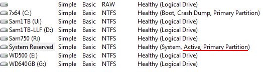

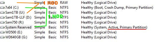

The short version:
Primary partitions may contain a bootable operating system, you may have a maximum of four (4) primary partitions on one HDD.
Extended partitions aren't bootable and can contain as many Logical partitions as you like, (well you could run out of assigned volumes under Windows if you go berserk).  Each HDD can contain one (1) Extended partition.
In my screengrab below, HDDs marked D:, R:, E: & G: each contain one Extended partition, (it occupies the full HDD), which each have one Logical partition.
Drive U: has one Extended Partition which contains two (2) Logical partitions, one being U: the other being the one with the RAW filesystem, it's encrypted with TrueCrypt and as such is unrecognisable by Windows until mounted.
Drive C: contains two Primary partitions, the 100MB System Reserved that W7 creates and C: which contains the OS.
The drive with System Reserved and C: is the only drive with Primary partitions, hence it's the only one that shows up in BIOS as being bootable.
I do however, have external drives that have a Primary partition because they are bootable.  They boot into an environment that contains various recovery programs, etc.
