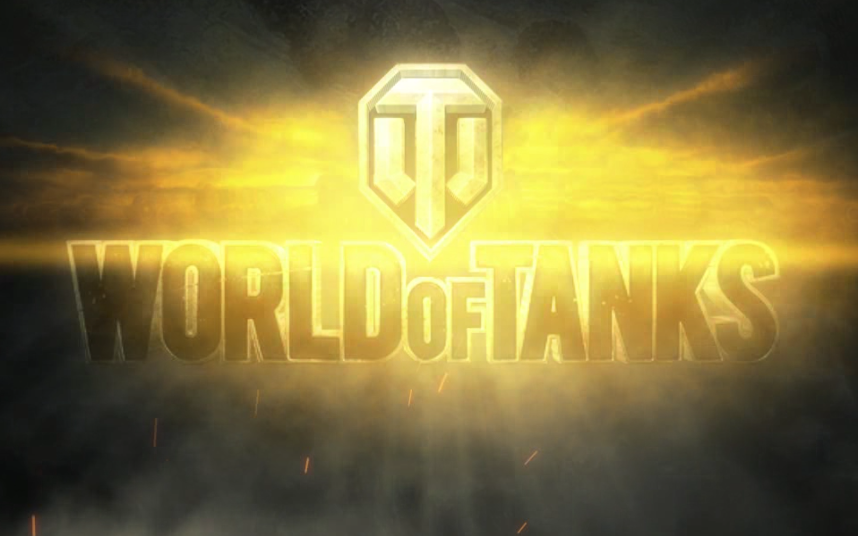

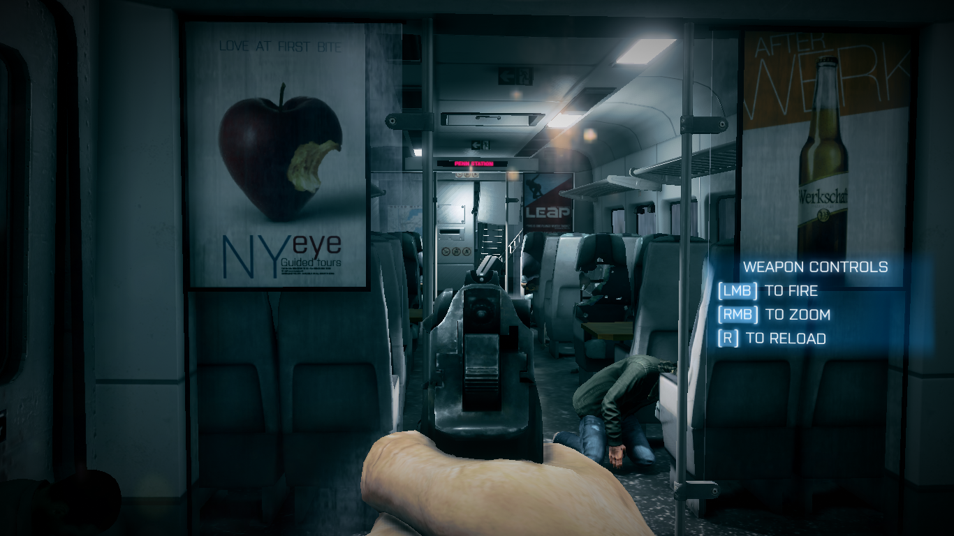

Worked for Battlefield 3 and World of Tanks (both D3D 10 I think)
Didn't work for Global Agenda (I think it is D3D10), AV in presenthook (something to do with that game it would seem)
