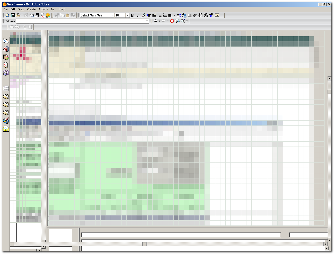

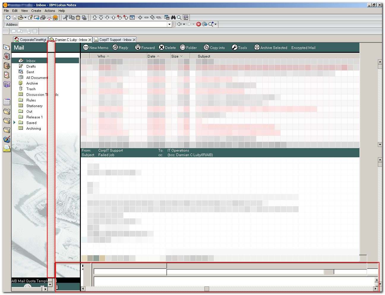

Just some feedback on capturing a scrolling window.  I tried it on Lotus Notes window which needed horizontal and vertical scrolling and it overlapped quite a bit, I then tried it on Microsoft Word 2003.  I created a table with the contents Line 1, Line 2, Line 3... and while the document had 49 lines per visible page, it captured the first page multiple times but never got past line 49 (it went up as far as 127).  I have attached the captured image.
Maybe it is how I am using it!

"I tried it on Lotus Notes window which needed horizontal and vertical scrolling and it overlapped quite a bit, "
but it's supposed to overlap, and then you are supposed to click to guess margins and guess overlap.. and that is supposed to stitch it together and remove overlaps.  did you try that?

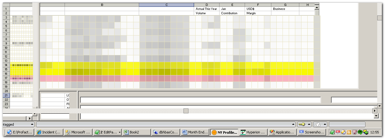

For MS Word -- it will only work if you set ms word to show a full page, and then tell sc to capture pages use simulated keypress method.

Don't I feel the stupid one?  :-[  That worked perfectly with Lotus Notes once I continued with the steps you mentioned.
After playing with the various options I got it to work just fine for MS Word.

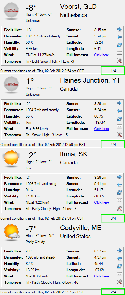

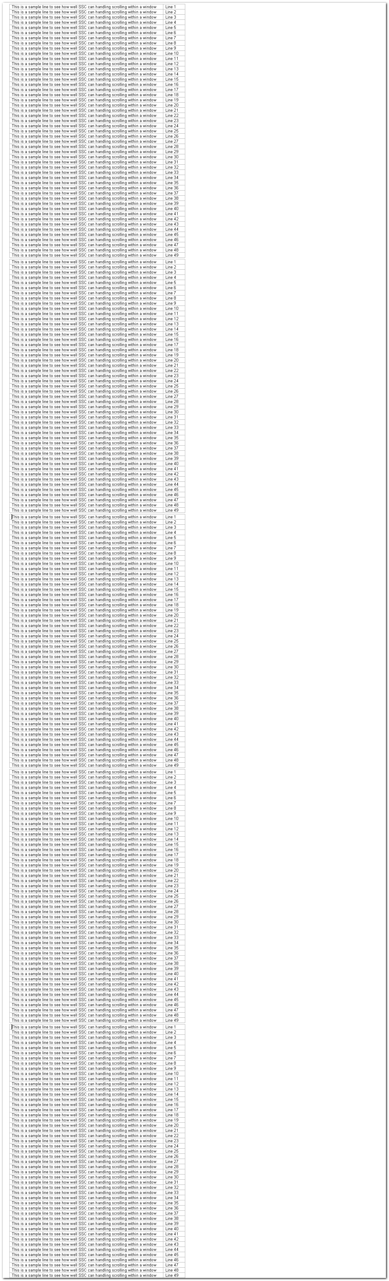

I'm a user of skwire's sWeather to view how it's outside, as I'm unable to view through a window sitting in my attic workspot :o
I thought I'd make a nice screenshot of the current weather in the 4 locations I've set. sWeather can change the current page by using PgDn/PgUp keys, but has the strange habit of scrolling in the opposite direction, so PgDn (or mouse-scroll down) actually goes from page 1 to 4, then 3, and then 2. Another PgDn returns to page 1.
This makes me best use the 'By Pages (default)' and 'Simulate Keypresses (PgDn/PgUp)' Vertical Scrolling settings for doing a capture.
This results in this captured image: (I highlighted the page-numbers)
My feature request would be that the scroll action by keypres can be reverted from PgDn/PgUp to PgUp/PgDn.
And it could be quite easily added by another entry in the combobox, something like 'Reverse Keypresses (PgUp/PgDn) (rare)'. The (rare) I added to emphasize that only in rare situations it would be used.
And I feel this could also go for the Left/Right keypresses of the Horizontal scroll setting.
/Ton
