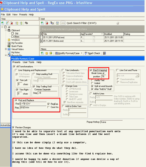

You can do that by regular expression f.ex.
FROM:
I need to be able to separate text at any specified punctuation mark onto it's own line and then insert a blank line between it and the next separation.  If this can be done simply (I only use a computer, I have no idea of how they do what they do).  I assume this can be done via something like the find & replace box.  I would be happy to make a decent donation if anyone can devise a way of doing this (and tell me how to use it).
TO:
USE:
[X] Regular Expression
Search for: (.+?)(\.|,)\s*
With EmEditor replace with \1\2\n
With HippoEDIT replace with $1$2\n
Explanation:
(.+?) means: search one-or-more of any sign, non-greedy, and store that in group no. 1
(\.|,) means: search an literal dot "\."  OR an coma, and store that in group no. 2
\s* means: match none-or-more space(s), we don't store that match but drop them (if any)
Then we replace with what is in group 1 by using \1 or $1, that's the matched sentence.
Then we replace with what is in group 2 by using  \2 or $2, that's the matched punctuation mark.
Then we add an line break or two by using \n
Please note that this may not work like that with all editors. The regex implementation is slightly different between different editors.
To get what you want:
just USE two '\n'
HTH?  :D
Greetings, Stefan.

Abterix: You have suggested using Regular Expressions, however, I only have the vaguest idea as to what a regular expression is and how it works.
Just google for 'regular expression wiki'
To use it I would guess I would have to have some software installed (you mention EmEditor & HippoEDIT which no doubt I would have to buy and learn how to use).
Not necessary, PSPad can do it also and is freeware.
But an dedicated app would be much more nifty of course.
BTW, our DonationCoder "Clipboard Help and Spell" can do it as well:
(here with an additional feature idea: 'split long lines without punctuation too at char number n' )
Greetings, Stefan.

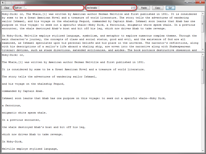

How's this:
You just have to enter the punctuation or other characters at the top, and dump your text into the upper pane. Clicking go produces output as shown.
I added some convenience buttons for clearing, copying and pasting.

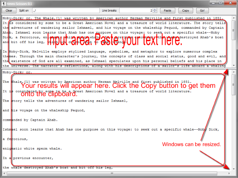

Later I'll put this in my coding area, with a proper little write-up, but for now this URL:
http://head-in-the-clouds.com/game/Scissors.jnlp
... will launch the program for you. You may get a warning that it's signed by an unknown publisher. That's ok, it's me  :Thmbsup:
Instructions:
1. Select and copy the text that is to be re-formatted so it's in your PC's (or Mac or Linux box) clipboard
2. Click the 'Paste' button or use Ctrl+V in the top window
3. Click the 'Go' button
3a. Go "ooh" and "aah" in admiration (optional step)
4. Select a subset of the results, or leave everything unselected (which gets you all text in the results area), and click the 'Copy' button - your formatted text is now available on the clipboard to do whatever-it-is-you-need-to-do with it.
