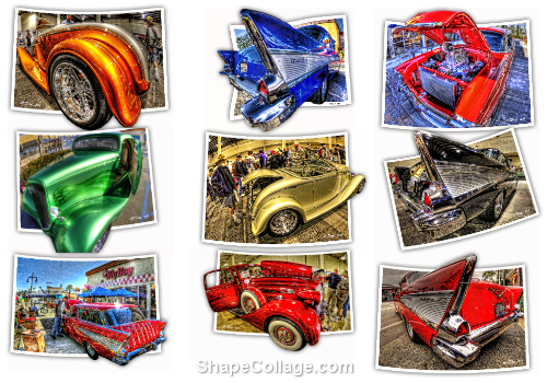

This is looking okay, but the black areas really should be transparent:
Having edited the original nine normal JPGs into nine full-sized .PNG photos with transparent areas on each one, I decided to tile them (as seen on the above thumbnail), but realized that none of my many photo editors would deliver! Either they wouldn't offer to tile, or they would not maintain the transparency. It seems most can handle transparency if I edit the photos one by one, but not when I combine/group/tile the pictures.
So, do you know of a photo editor that will both combine/tile, and keep PNG transparency?

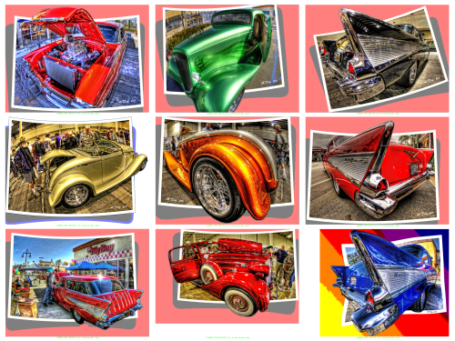

Re: any photo editor that will both combine/tile, and keep transparency?
« Reply #6 on: November 13, 2011, 11:28 PM »
IrfanView > 'create contact sheet' can both display and create PNG transparency, but not transfer it from the original PNGs to the final contact sheet, when combining:

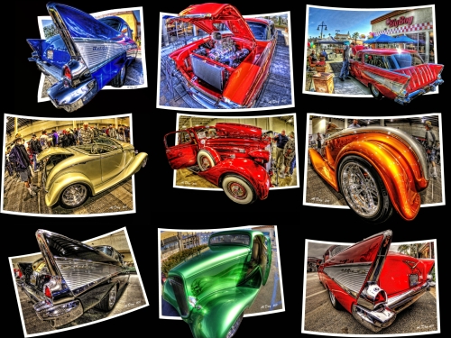

Curt, have a look at Shape Collage - with a bit of fiddling about it could perhaps do what you want ?
« Reply #12 on: November 15, 2011, 07:30 PM »
-thank you, joiwind  :up:
The $40 Shape Collage Pro does the trick!
Even the free version can do it, but with nag screens and watermarks:
PNG transparency:

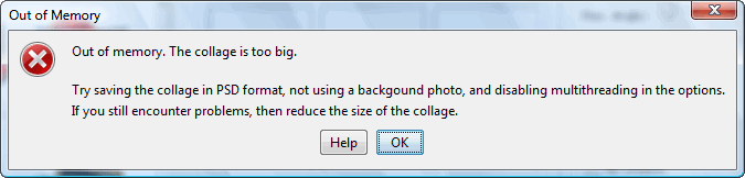

I first tried to ask Shape to create a full sized (10.000x8.200 pixels) collage. This was not all possible:
32-bits Vista, 4xQuad, 3.4 GB RAM > 1 GB available.
