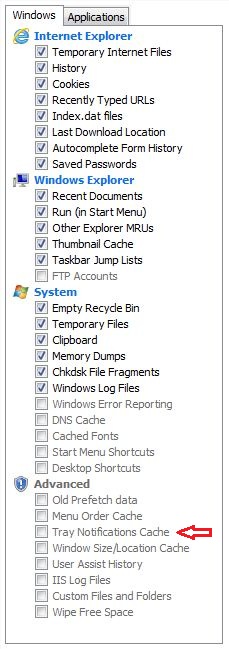

If you've got CCleaner installed, you could try enabling Tray Notification Cache, like so:

just tried ccleaner, after restarting the explorer process and also restarting windows, the stupid icon is still messed up  :'(
