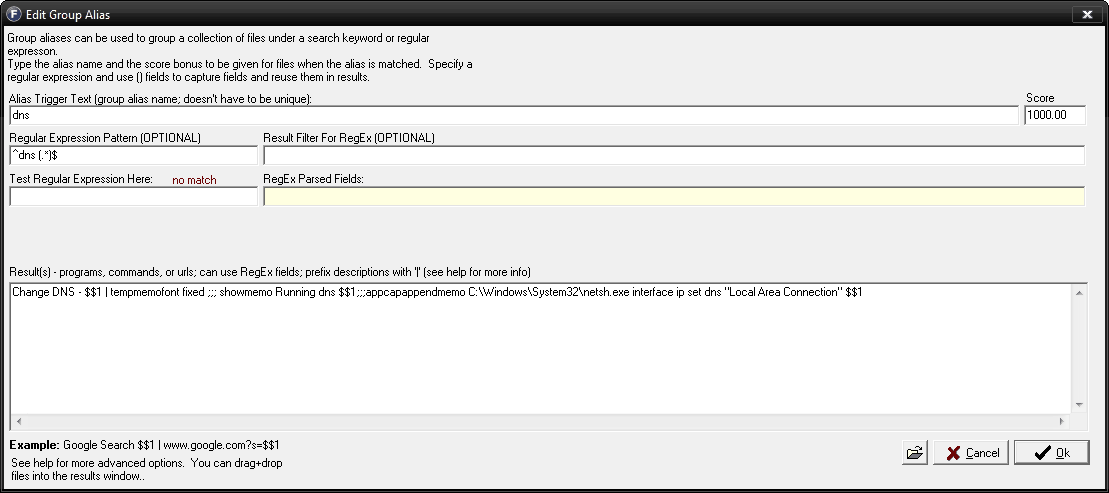

I am adding a screen shot for reference:
Re: netsh alias problem
« Reply #9 on: September 26, 2011, 06:56 PM »
Thanks a lot mouser! It's working perfectly!
Great!  Thanks for your patience and for posting a solution  :up:
