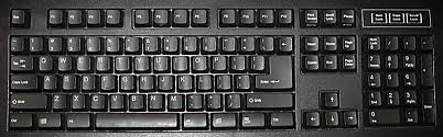

@Stoic Joker
So he's got nothing looking for F8 to catch the keystroke.
Some keyboards don't recognize the F keys on boot up at all.
I have one that does not, could not even get to safe mode,
till I figured out the keyboard will not see the F keys on bootup.
Not sure if this is the case with that keyboard.
But it happened to me with an HP keyboard,
so I had to hookup another keyboard to get to my boot options.
That's all the help I can offer, the rest is out of my understanding, most of it.

Usually with a multi-media keyboard (which is part of why I hate them). A lot of the MM Keyboards like to toggle the default usage of the F-key row between its intended/proper purpose and a bunch of daffy media shortcuts. This behavior makes the keyboard completely useless unless you can remember which hotkey combo will force the keyboard to go back to acting right.
Yeppers! :Thmbsup:
« Last Edit: September 16, 2011, 05:18 PM by 40hz »

@40hz
The connector is purple, green was for the mouse....damn, just now I gave away my "computer age" away  :P
Re: Is Windows 7 boot management more broken than ever?
« Reply #19 on: September 16, 2011, 11:25 PM »
@40hz
You're correct. I neglected to look. It is puke purple. ;D (Thx for catching it.  :redface:)
