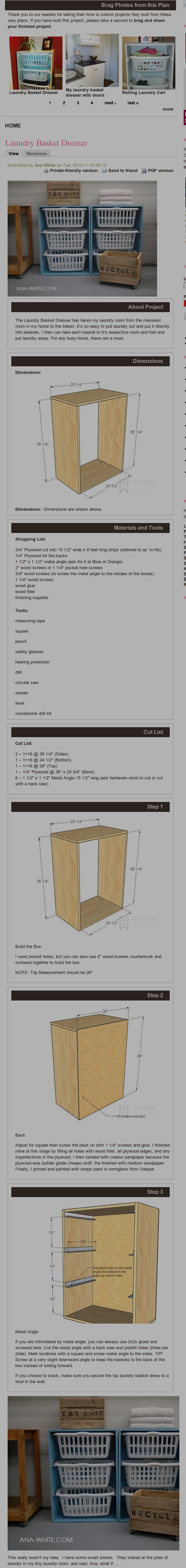

Shopping List:
3/4″ Plywood cut into 15 1/2″ wide x 8 feet long strips (referred to as 1x16s)
1/4″ Plywood for the backs
1 1/2″ x 1 1/2″ metal angle (ask for it at Blue or Orange)
2″ wood screws or 1 1/4″ pocket hole screws
3/4″ wood screws (to screw the metal angle to the insides of the boxes)
1 1/4″ wood screws
wood glue
wood filler
finishing supplies
Tools:
measuring tape
square
pencil
safety glasses
hearing protection
drill
circular saw
sander
level
countersink drill bit
The rest are better off read from the site. There's both a PDF and Printable list for the page:
Source: http://ana-white.com/2010/11/laundry-basket-dresser (via Fee_Berry's home subjot)
