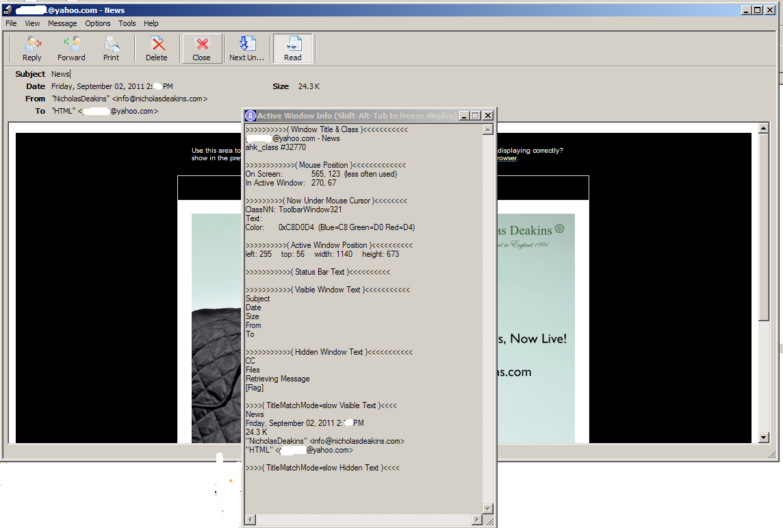

I need to record macros to programs that have GUI elements/controls, that do not have classnn, or other distinguishable characteristics.
Eventually, most applications have them, but they can hide it in certain situations. When building WinSendKeys I had a bit similar issues, and reverted to doing other-control-relative mouse-clicks, usually it's toolbarbuttons that don't have these classnames/classnn, but the toolbar or it's surrounding windows has, and the toolbar is often in a fixed location.
Can you give examples of applications that hide (most) controls like this? I know Firefox 4.0 and later has issues in this arena, and some apps created using C++Builder 6 have the issues with the toolbars, mentioned above, but I haven't found much other applications with this behavior.

there are so many controls that are not identifiable, for example in Pop Peeper:
I hover over the Close button, and there is nothing I see that distinguishes it from eg. the Delete button:
